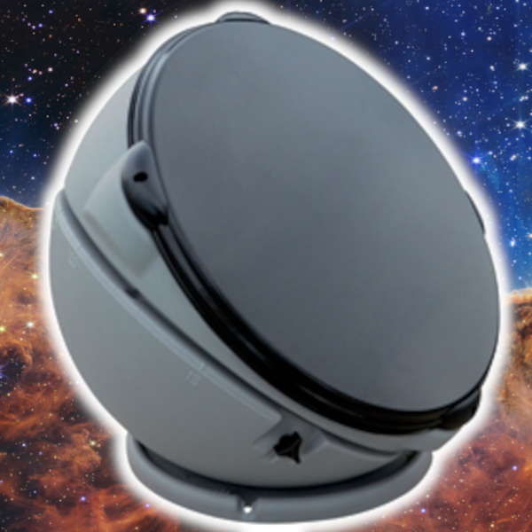

The build uses a satellite dome salvaged from an old RV that [Koakno] scored for just $5. Specifically, a Winegard Carryout Anser GM-5000. The motorized parabolic dish was designed to track TV satellites, but here it’s been repurposed into a scanning radar antenna for X-band signals. It’s paired with a cheap SDR—you can use several on the market—which injects an 850 MHz signal, which is up-converted to 10.4 GHz by the low-noise block (LNB) in the GM-5000 and sprayed out towards the weather.
Echoes come back from rain, hail, and debris, and get down-converted by the LNB back into an 850 MHz signal that the SDR can capture. The echoes are then plotted on a Plan Position Indicator (PPI) display, showing what’s going on in the atmosphere around the dome. [Koakno] reckons detection ranges span out to 40 km for things like heavy rain, while a supercell hail core could be spotted at up to 60 km in the right conditions.
It’s worth noting something important, though. [Koakno] explains that this system is currently in violation of FCC regulations, and shouldn’t be used without the proper licenses to access given spectrum. It’s a useful study of how to build a weather radar, but perhaps not something you can just wire together and fire up without getting in a spot of bother.

    Like how does a LNB turn into an upconverter and transmitter? Especially one that does transmit and receive? Especially when the SDR transmitter is connected to the output of the LNB?
    FMCW buys some process gain, and X band (10.4 GHz) gives higher return than the usual weather radar S band. BUT how on earth do they expect 1-5 mW of power to get 3-8 km of range when it takes literally almost a BILLION times more power (1 MW) in a conventional weather radar to get out to 200 km.
    Smells like a huge project ingredient here is “wishful thinking”. I do note the distinct lack of any images or data.
    1. There is no FMCW or anything, the current, seemingly incomplete state of the SDR code just blasts a full power carrier wave as the pulse and that’s it. The receiver side doesn’t seem to work with live data in the current version.
    2. Range in RF signals is not linear, but exponential. So a range of 3km with 5mW while a Range of 200km with 10kW is somewhat plausible.
      The github readme dies not give any details on what he does to the LNB to make it transmitt, there is only a GUNN diode on the parts list as a 10GHz source. Did not open the zip. Who puts zip files on Github?
      I highly doubt it is possible to make one LNB transmit and receive at the same time. I have seen people inverting an LNB for TX, but only by de-soldering and mechanically flipping all tranistors inside, and additional bypassing filters. So in the end it is again one direction only.
