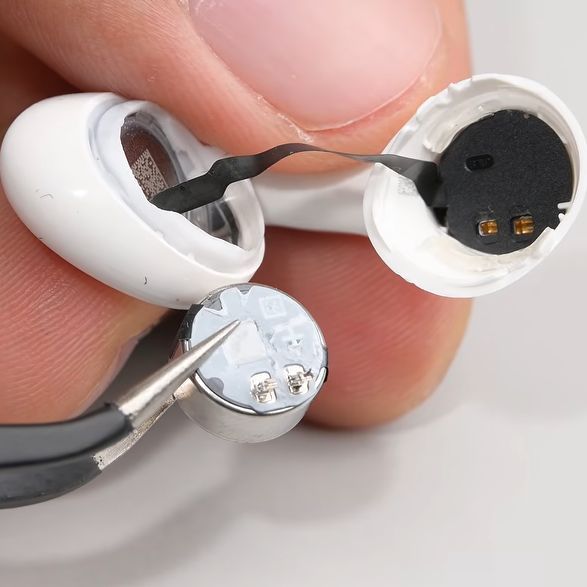

Interestingly, with the fifth generation it would seem that a battery swap in the earbuds is now actually possible without whole-scale destruction, according to the [iFixit] teardown video.

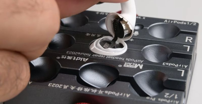

Although it’s still a far cry from the demonstrated FairBuds battery replacement, this time around a bit of gentle heat allows for the glued-together earbud to cleanly separate, with inside a socketed coin cell. The catch here is that the polarity on these sockets differs between the left and right earbud, which was discovered after a quick swap.
Unfortunately this same easy-to-open change doesn’t carry over to the case for the earbuds, which still requires  physical destruction of the plastic to get to its battery. Accordingly [iFixit] gives this generation of AirPods a generous 2/10. Although a step in the right direction, it seems clear that if repairability or even simply being able to replace the batteries is a concern, the AirPod’s probably aren’t for you.

  3. I’m so curious how mirrored batteries made it through their design process….
    Like surely using the same cell on either side would be a supply chain and assembly risk simplification?
    Or they just took the concept of just mirror the cad to the extreme…
    1. They’re not mirrored, the pins on one side are also offset differently.
      This is Apple we’re talking about. If you’re buying 10 million of one battery or 5 million of one and 5 million of another probably doesn’t matter at that scale. You’re already selling at a huge markup after all.
      1. Nah, the real trick is that the rich elite have access to portals from the mirror universe. So Apple only has to make one side and then trade half with their counterpart.
    2. Just speculating, but it could be about RF noise. It must be tough having electronics and power jammed so tightly next to antennas and speakers. The PCBs may be laid out to reduce noise from the power source bleeding into the antenna and speakers.
