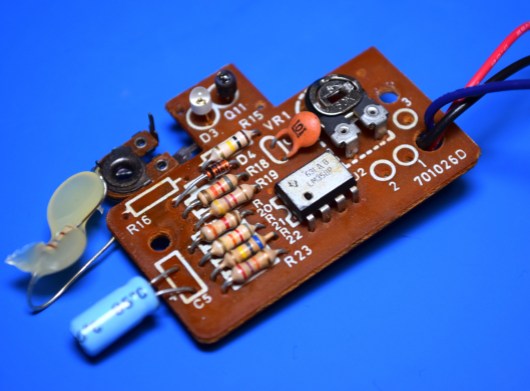

The back of each card features a linear barcode, which is picked up by an infrared reader mounted under the tray. It would appear the codes store some sort of lookup information (presumably related to the string of characters printed within the code) that tells the Whiz Kid which of the pre-loaded words the user is supposed to be spelling. With creative use of the instructions and imagery on the cards, VTech was able to create many different games and activities that ultimately revolve around the list of words the Whiz Kid has stored internally.
The reader itself is quite simple, and is not unlike what you might find in an old mouse. An IR LED and detector are placed into a housing so that that the alternating white and black stripes passing in front of them will produce a voltage change in the detector. This is fed into an LM358 op-amp to create a clean square wave the microcontroller on the main PCB can easily read. There’s only three wires between the main board and the reader, which makes it easy to hook the oscilloscope onto the data line and see this exchange happen in real-time.
I didn’t attempt to decode the signal, so feel free to chime in for extra credit in the comments. But from the looks of it, the code holds at least a few bytes worth of data. Certainly enough to hold two hex characters, and as there’s only 50 cards in a pack, that would offer more than enough possible combinations to use as a unique ID.

  10. Interesting that the cats reader was so poor. I know these were built to a price, but just one more IR detector you could have printed a “clock” on the card as well to alleviate all that pain.
    1. In consumer electronics development, the joke is to design the product so that it works, throw away half the components and make it work again (I believe that was from Steve Garcia of Circuit Cellar fame.) Bil Herd in one of his talks tells how he once worked all day to eliminate a <$1 part from his design because Commodore had to first buy all the parts to make those units before selling them to the channel. So if you're building 1 million units, a $1 part == $1 million dollar additional cost upfront.
      The card's bar code pattern looks like VTech tried to make it self-clocking so one detector should be fine. The black and white areas alternate and (from the top-down) start at regularly-spaced intervals. The two different widths of a black bar seems to indicate mark or space. Looks like one start bit, 8 bits of data, then a stop pattern? With that scheme the software decoder can be designed to be pretty tolerant to how fast and steady the card is pulled, but it's possible the chip's speed and memory forced them to use a smaller, simpler, and not-so-good algorithm.
      1. The parts reduction technique is known as “Muntzing”, named after Earl “Madman” Muntz circa 1950. Read the wikipedia articles.
    1. My guess is start + 8 bits + stop, asynchronous with embedded clock. This method was also used for bin/tray identification in automated warehouses before modern barcodes came into fashion.
    2. They are variable width though, so a thicker line is presumably meant to be two bits. So I’d interpret that scope output as something like:
