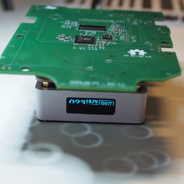

As computers have gotten smaller and less expensive over the years, so have their components. While many of us got our start in the age of through-hole PCBs, this size reduction has led to more and more projects that need the use of surface-mount components and their unique set of tools. These tools tend to be more elaborate than what would be needed for through-hole construction but [Tobi] has a new project that goes into some details about how to build surface-mount projects without breaking the bank.
The project here is interesting in its own right, too: a display module upgrade for the classic Game Boy based on an RP2350B microprocessor. To get all of the components onto a PCB that actually fits into the original case, though, surface-mount is required. For that [Tobi] is using a small USB-powered hotplate to reflow the solder, a Pinecil, and a healthy amount of flux. The hotplate is good enough for a small PCB like this, and any solder bridges can be quickly cleaned up with some extra flux and a quick pass with a soldering iron.

  1. Looks like the display says ‘SHIT’ there, later realize it is prolly ‘SHUT’
    Love the coloring of the display on this ‘original’ gameboy.
        1. I have the same hotplate and it can’t get beyond 260°C, so I end up with burned flux and unflowed solder. Mine might be defective but it is certainly SHIT.
          1. There’s a type of paste with a lower melting point – it starts melting at around 140 °C. You can run it on a reflow profile with a peak temperature of 210–220 °C. Honestly, I think the plate is pretty good value. I like my MHP50, but the cheap one actually did a great job.
          2. I use leaded solder paste and by the time plate reaches target 190°C everything is already soldered (stars to melt at around 120).
            There is something wrong with my unit though, it sometimes scrambles the display until it cools down. But for the price it’s worth it.
          3. There is a very good reason these things are explicitly sold as “preheaters” and not reflow plates. You’re still expected to use hot-air from above to hit the actual reflow temp.
