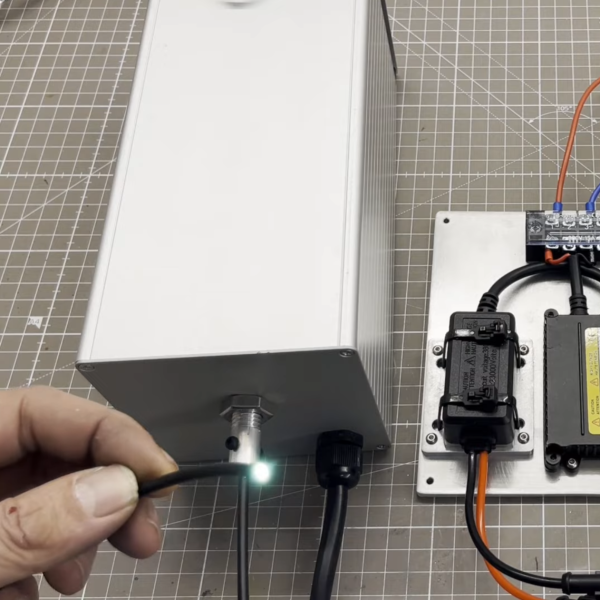

An aluminium box is visible on the left side of the image, with a power supply on the right side, and a lamp ballast in the middle. A man's hand is holding the end of an optical fiber in the lower left corner, and it is emitting a white light.
Before a spectrometer can do any useful work, it needs to be calibrated to identify wavelengths correctly. This is usually done by detecting several characteristic peaks or dips in a well-known light source and using these as a reference to identify other wavelengths. The most common reference for hobbyists is the pair of peaks produced by a mercury-vapor fluorescent light, but a more versatile option is a xenon-bulb light source, such as [Markus Bindhammer] made in his latest video.
A xenon gas discharge produces a wide band of wavelengths, which makes it a useful illumination source for absorbance spectroscopy. Even better, Xenon also has several characteristic spikes in the infrared region. For his light source, [Markus] used an H7 xenon bulb meant for a vehicle headlight. The bulb sits in the center of the source, with a concave mirror behind it and a pair of converging lenses in front of it. The converging lenses focus the light onto the end of an optical cable made of PMMA to better transmit UV. A few aluminum brackets hold all the parts in place. The concave mirror is made out of a cut-open section of aluminum pipe. The entire setup is mounted inside an aluminum case, with a fan on one end for cooling. To keep stray light out of the case, a light trap covers the fan’s outlet.
[Markus] hadn’t yet tested the light source with his unique spectrometer, but it looks as though it should work nicely. We’ve seen a wide variety of amateur spectrometers here, but it’s also illuminating to take a look at commercial scientific light sources.

  1. I’m a little bit surprised by the way the two condensor lenses are put in the optical path. I always thought that condensors of this type is desigend with flat side pointing to the lamp, an the (strong) conves surface to the side, where the light rays ar more or less parallel. Compare to the design of the illumination system in a slide projector.
    1. I’m a little confused about the optics too. I think I’d have to do a ray trace and understand the fiber coupling.
      Not that it matters much but I do wonder what the lenses are made out of. One of the advantages of these xenon lamps is they emit some UV, while LED sources don’t. I think those are pmma lenses, big thick ones. I bet there’s a good deal of intensity loss in the uv because of the lens choice here. It’s probably still sufficient, but that looks like 3cm of lens path length.
      All that said I do see bright light coming out of the fiber so it’s a win.
        1. Didn’t it say to focus UV? That would be quartz. But as he says in the video, quartz is too expensive, and quartz that size would be way too expensive. So boro-silicate it is. It will calibrate out.

  3. For his light source, [Markus] used an H7 xenon bulb meant for a vehicle headlight.
    Vehicle headlight bulbs are not xenon, they are metal-halide vapour bulbs. “Xenon” is nothing more than marketing lie for vehicle headlight bulbs.

      1. Problem with that project is that author use metal halide lamp thinking it is xenon one and planning to calibrate his device using spikes in spectra of metal halide lamp as if it is spikes of xenon.
        Car bulbs never was xenon ones. They are all metal halide. And spikes of metal halide is off by dozens nanometers from xenon ones. Metal halide spectra spikes are perfecly fine for calibration too, you just need to use correct values for metal halide, not for xenon.

  4. Yeah, as MM points out, those aspheric lenses definitely aren’t pointed in the right direction. I have to assume Markus tested it and found this gave him a nicer-looking beam shape (or some other criteria), but he’s certainly leaving a lot of efficiency on the table. Same with that light blocker on the back end — it’s certainly not operating as a reflector.
    But more curious to me is: Where is the air exhaust? He goes through a lot of trouble to fit a fan with a light-blocking vent, to blow air into the enclosure, but there is no exhaust light blocker, and no obvious exhaust air path at all: No airflow through the enclosure!
    1. The two plano convex lenses forming a biconvex converging lens. I tried out various configurations and this one had the best result. Thorlabs uses the same configuration in some of their light sources, if I remember correctly. The lenses are made of borosilicate glass. Quartz would be better, but they are very expensive. The fan is a static pressure fan, recommended when using a filter (light trap). As I don’t own a CNC mill or lathe, I’m dependent on semi-finished products. I know that a mirror made from a cut aluminum tube is not ideal:)

        1. thank you Paul. The reason is spherical aberration which grows with a higher power of the angle of incidence of the light rays. This can be reduced by ‘balancing’ the curvatures of the lens on both sides, resulting in pointing the surface with higher curvature to the lamp, one of the simplest measure in lens design. In addition the surface with curvature in such condensers has a quite aspheric shape (which, may be, makes the thin gs worse when the lens is put in in the wrong way). – Putting in the lens in the wrong way leads to a reasonable defined spot with a strong halo (see video after 2:28). And when we talk about efficiency we have to take into account the numerical aperture of the fiber the light ist sent through. It would be interesting to compare the light intensity at the end of the fiber for the two lens configurations ‘flat to flat’ and ‘convex to convex’.
