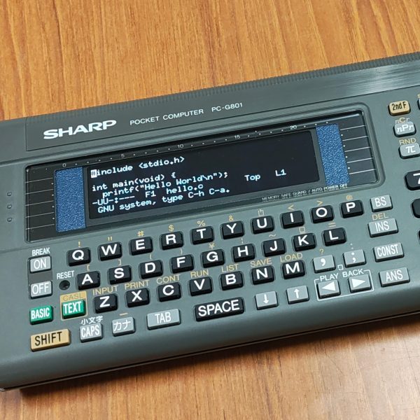

Damaged Pocket Computer Becomes Portable Linux Machine
The Sharp PC-G801 was an impressive little pocket computer when it debuted in 1988. However, in the year 2025, a Z80-compatible machine with just 8 kB of RAM is hardly much to get excited about. [shiura] decided to take one of these old machines and upgrade it into something more modern and useful.
The build maintains the best parts of the Sharp design — namely, the case and the keypad. The original circuit board has been entirely ripped out, and a custom PCB was designed to interface with the membrane keypad and host the new internals. [shiura] landed on the Raspberry Pi Zero 2W to run the show. It’s a capable machine that runs Linux rather well and has wireless connectivity out of the box. It’s paired with an ESP32-S3 microcontroller that handles interfacing all the various parts of the original Sharp hardware. It also handles the connection to the 256×64 OLED display. The new setup can run in ESP32-only mode, where it acts as a classic RPN-style calculator. Alternatively, the Pi Zero can be powered up for a full-fat computing experience.
The result of this work is a great little cyberdeck that looks straight out of the 1980s, but with far more capability. We’ve seen a few of these old pocket computers pop up before, too.

        1. It is fair to admit that this project was, in a sense, driven by a pursuit of technical romance. While I could have designed a completely new enclosure with a 3D printer, I cannot deny that there was also an intention to fit everything inside the original chassis and surprise anyone who saw it. That said, it is very difficult to find a small keyboard with properly engraved characters (and lining up tactile switches makes labeling problematic), so modifying an old handheld device to build this kind of cyberdeck is, I believe, not a bad approach at all.
          While building this device, I also noticed some practical advantages. Although it can of course function like a Raspberry Pi–based IoT device—equipped with sensors for environmental monitoring and so on—you still need a display and keyboard to configure its Wi-Fi settings. You cannot immediately use it when bringing it into a new environment. But with a display of this size, you can quickly configure the network using commands like nmcli. Once the network is set up, you can SSH into the device from outside, or even launch startx and access the desktop remotely via VNC.
          I also made the ESP32 built into the device operate as an RPN scientific calculator when booted on its own, precisely because situations like the one you pointed out tend to occur. Aside from surprising people, the device will likely be used as a calculator most of the time. That was also true back when devices of this type were in active use. Raspberry Pi OS takes tens of seconds to boot, whereas the ESP32 calculator starts instantly. In that scenario, the batteries last much longer as well, so I also believe that, in practice, it will most often be used as a calculator.
          In any case, running a modern OS in an old form factor is exhilarating. And the ability to use Python instead of BASIC will likely make the device even more appealing to people today.
