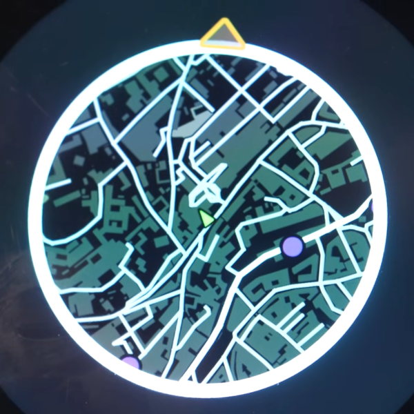

Before getting to the hardware, though, the map itself needed to be created. [Garage Tinkering] is modeling his mini map on Need For Speed: Underground 2, including layers and waypoints. Through a combination of various open information sources he was able to put together an entire map of the UK and code it for main roads, side roads, waterways, and woodlands, as well as adding in waypoints like car parks, gas/petrol stations, and train stations, and coding their colors and gradients to match that of his favorite retro racing game.
To get this huge and detailed map onto small hardware isn’t an easy task, though. He’s using an ESP32 with a built-in circular screen, which means it can’t store the whole map at once. Instead, the map is split into a grid, each associated with a latitude and longitude, and only the grids that are needed are loaded at any one time. The major concession made for the sake of the hardware was to forgo rotating the grid squares to keep the car icon pointed “up”. Rotating the grids took too much processing power and made the map updates jittery, so instead, the map stays pointed north, and the car icon rotates. This isn’t completely faithful to the game, but it looks much better on this hardware.
The last step was to actually wire it all up, get real GPS data from a receiver, and fit it into the car for real-world use. [Garage Tinkering] has a 350Z that this is going into, which is also period-correct to recreate the aesthetics of this video game. Everything works as expected and loads smoothly, which probably shouldn’t be a surprise given how much time he spent working on the programming. If you’d rather take real-world data into a video game instead of video game data into the real world, we have also seen builds that do things like take Open Street Map data into Minecraft.

    1. Started watching the video and dude is very proud of doing something others told him was impossible. My guess is others considered compute required to rotate 800×800 map and deemed it infeasible on ESP32. @17:00 he finally confesses rotation is tanking performance and settles on static map. Personally Im quite surprised after looking up esp32-p4 variant, its dual core 400MHz, should have no problem smoothly rotating 800×800 worth of tiles.

        1. The issue is more to do with the LVGL buffering implementation (which is what I used in this first iteration). Even when you utilise the PPA and matrices options of the P4, rotation still seems to max out around 4fps due to the way it compares the buffer frame by frame. I’m only rotating what’s on screen, but it’s still computationally heavy it seems. It’s not terrible and kinda fits the >20 year old aesthetic, but it’s not great.
          Currently looking into getting vectors going on it, but it’s a much bigger task, as well as decoupling the markers and a few other things that will effect performance both positively and negatively.
