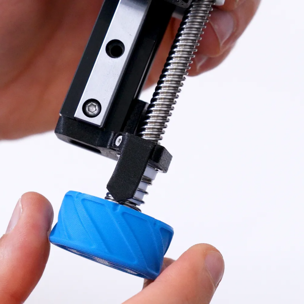

When taking macro photographs, you often need just a tiny bit of controlled motion — so little that it’s tough to pull off by hand. To address this, [Salveo] designed a small open-source macro photography slider featuring an anti-backlash handle.
Macro photography gives you an extremely shallow field of view, sometimes under 1 mm of depth, in which subjects stay in focus. To combat this, it’s common to capture multiple images while sliding the camera forward or backward, then combine them for a much larger depth of field than a single shot provides. [Salveo]’s slider gives fine control over this focus-stacking process, with the knob even marked to show every 1 mm of linear travel.
The slider is built around a 150 mm linear rail, though it could easily be lengthened or shortened to suit your needs. A T8 leadscrew, paired with anti-backlash nuts, translates the knob’s rotation into smooth linear motion. The knob itself uses a custom-designed anti-backlash mechanism to ensure the slider works cleanly in either direction.

  1. Great job on printing the anti backlash mechanisms. I will never get tired of seeing linear positioning mechanisms and all of their applications.
  2. I like it! Antibacklash nuts for the knob and the camera slider nut are very good.
    I might build it with a second, finer position adjuster using a differential screw. That would allow precise positioning down to 10 um or so and allow for higher magnification macro photography using focus stacking.

  4. Lol it’s easier just to adjust focus in increments, unless you’re working at the edge of your focal length… Which you probably are
    1. Adjusting focus can lead to focus breathing. That means the chang in focus can also changes the magnification. This becomes more of an issue at higher magnification. Depth of field is often so thin that any backlash in the focusing system will also throw things off.
    2. Hi, Victor –
      Have you tried this? Because really, it’s not! Focus breathing aside, it is very difficult to adjust the focus distance of a lens (which is what I think you meant, not focal length) in uniform, fine increments by adjusting the lens. Especially when having to do so over tens (and sometimes hundreds) of exposures. With many lenses, depending on their optical and mechanical design, it’s not even possible.
