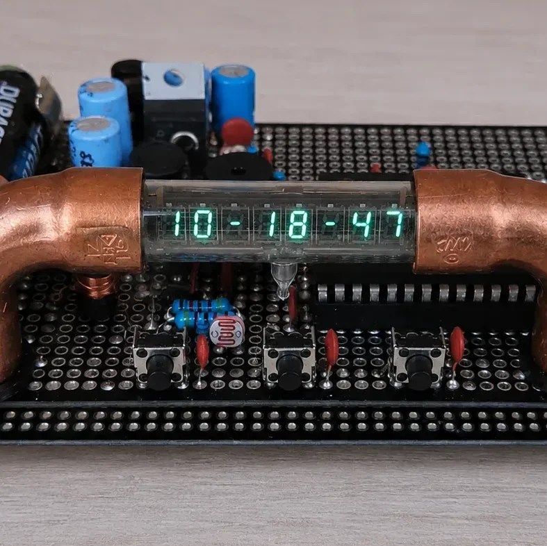

There are lots of different ways to build a clock. [Sciter_] came into the possession of some old calculator parts, and decided to reuse them for just such a project.
The heart of the build is an ATmega328P microcontroller, running off of a 32.768 kHz crystal. This allows the chip’s counters to neatly divide down the frequency to get a steady 1 Hz pulse for accurate timekeeping. Time is displayed on a vacuum fluorescent display (VFD) harvested from an old calculator. These displays need rather high voltages to run, which in this case are produced by a HV5812 driver chip and supporting circuitry. The display itself is neatly cradled in a pair of copper pipe elbows for a stylish look, with some addressable RGB LEDs present to provide some charming underglow.
Power for the device comes from a single AA battery, using a transformer-based low voltage converter. Alternatively, it can run off a USB 5 V power supply, which also charges the NiMH AA cell while available with the aid of an LM2576-ADJ buck converter.

  1. It’s actually 5V USB powered with AA battery full backup. A major battery eater because the VFD filaments alone are around 1/2W then add the boost converter… I don’t see an RTC used.

  2. Those LEDs are described in the text as “small elongated COB-style LED bars”, not addressable RGB, and are each driven via a 5k1 resistor. In any event the idea of putting them in the glass tube from a fuse is definitely one to remember.
