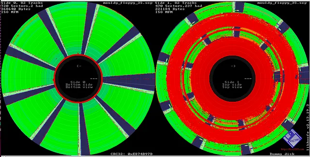

Visualizing a disk’s flux stream can identify debris and damage.
There’s no telling how much data could potentially be lost to time because its stuck on such an antiquated and fragile storage media, and the situation only gets worse with the passage of time. The problem isn’t just that modern computers don’t have floppy drives. The disks themselves degrade with age, a process which is accelerated if they aren’t stored properly.
As such, Copy That Floppy! only briefly touches on the most ideal situation — that is, buying a USB floppy drive and making copies of the bog standard 3.5 inch disks you might come across. It then moves right on into more advanced topics, such as interfacing with less common drive types, how to safely clean floppies, and the use of advanced tools such as Greaseweazle to analyze captured disk images.

  2. This article leaves out far too much information on the situations. he flux image shown says basically nothing but location of failed reads. It reminds me of trying to read bad floppies with the Greaseweazle software and it was unable to re-read bad areas. This and incredibly bad floppies [1] is what triggered me to build my own host software RecoveryWhiskers [2].
    I want to re-iterate why archiving and archiving floppies is important: Public archives are disappearing from the internet. This is an alarming trend.
    But a lot of software is not archived or filed properly. What we need is more people doing library work: Fill software libraries with software, fill out metadata, briefly describe what it does and collect all versions you find.
    Interestingly floppies are less of a time critical issue: If stored properly, 30-40 year old floppies are still good. There are a few main causes of bad floppies:
    Dirt & nicotine residues: Sometimes there is so much dirt on a floppy that reading it would act as an abrasive medium one you apply pressure onto the head.
    Mold & moisture exposure: Most kind of molds sits on top of magnetic medium where it found some moisture. If they sit above, simply cleaning them with 70% IPA or n-Heptane will provide help there (use woven cotton flat q-tip). Some other molds grow into the magnetic coating and already destroyed some of your data.
    Another thing I discovered is a set of bad manufacturers: I call them self-destroying floppies. Some have issue with their binder being too weak or their sleeves being too abrasive. I’ve only seen this in a handful of brands.
    What’s important to note that none of these issues makes reading them now a time-critical matter. You already got a bad batch of floppies. If you keep your floppies well in a dry place that’s not too hot, all eventual elemental damage already happened. The magnetic medium will be fine though.
    What I want to say: Magnetic media is incredibly sturdy. Go back up your old hard drives and read your homemade CD-Rs and DVDs before their coating flakes off. Look for artifacts on media you find and see if this exists in the form you find it.
