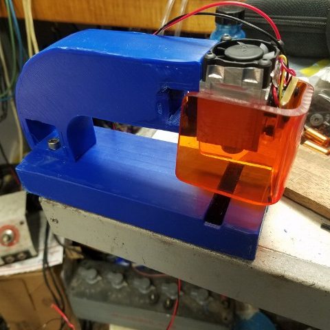

Can you call it a bandsaw if it has neither band nor saw? [WeldingRod1] does, with his entry in the laser contest — a manually-controlled laser cutter that he’s dubbed a Laser Bandsaw. Some might quibble that it’s not actually sawing with the beam, and others will inevitably find the safety implications rather frightening. We think it’s a fun project and that [WeldingRod1] can call it what he wants, as long as he follows his own advice and keeps his laser goggles firmly on his precious vision orbs.
He has actually put some thought into what started as the physical manifestation of a joke in a podcast. The blue diode laser — a NUBM44 diode rated at 7 W — got a custom-made copper heatsink. It’s also got a hefty beam dump in the form of a stack of box knife blades. That’s very necessary to keep the beam from reflecting where it shouldn’t, especially when you consider this operates like a regular band saw: you turn it on, and it’s ready to cut. With only 7 W of laser power it can’t cut that much, mind you, but apparently it’s great on balsa wood and blasts black paint off like nobody’s business.
Now if this was our shop we’d probably want to put the laser diode onto some kind of CNC platform, be it Cartesian or SCARA. But we’ve seen that done many, many times and if you’ve got the motor skills this might be just the tool for you. There’s a pinout and STLs for the 3D printed frame on the project page if you’re interested. If not, why are you still here? The article is finished. Go make something lase and send it in. The deadline for the 2026 Frikkin Laser Contest is fast approaching!

  3. As a scroll/band saw doesn’t cut until something is pushed into the blade, this should function likewise. I suggest an optical mouse sensor be used to detect movement of the workpiece. No motion, no laser. If you want to be really fancy, you could modulate the power of the beam based on the speed of the motion.
    1. yeah good idea. might be even easier to have a temp or photo sensor on the ‘beam dump’ side of the thing to detect if when it’s made it through
  4. blades as a beam dump? any reason why? (i did not see an explanation of the choice in the project page and i will not be watching the video sorry thanks)
    1. The sharp edges means minimal reflection(top surface width) and the tight angle of the blade faces means reflections are channeled further into the stack of blades and not reflected sideways.

      I built in as much shielding/guarding/reflective path limiting as I could semi-reasonably get in there. That’s the function of the U-shaped orange part, an analog of the upper guide and blade guard on a bandsaw; it is made from laser blocking plastic specifically tested for these blue lasers. Yes, it does cut pretty well on this laser; a good confirmation that it absorbs in the blue range. The column blocks another quadrant pretty well.
      This is never going to be a 100% safe tool, but I submit that its not significantly more hazardous than a bandsaw. The laser beam in question has a definite focal point; the beam spread away from there is quite significant. During testing (WHILE wearing laser safety goggles) I projected the laser beam onto a wall a few feet away. The power density falls quite rapidly as you get away from the focus; I didn’t even warm my wall up.
      Its honestly mostly a “can I even build such a thing???” kind of project. Not actually a useful tool. The power level is just too low to do much functional cutting. Plus, it comes with all kinds of charring!
