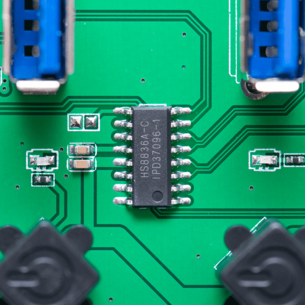

[Dr. Gough] bought a generic USB 3.0 hub on an Asian website. Surely, USB 3 is mature enough that even the cheapest hub will have some IC in it that will work well, right? You’d think so, but a little exploratory surgery showed that the only thing about this hub that was USB 3 were the blue port connectors.

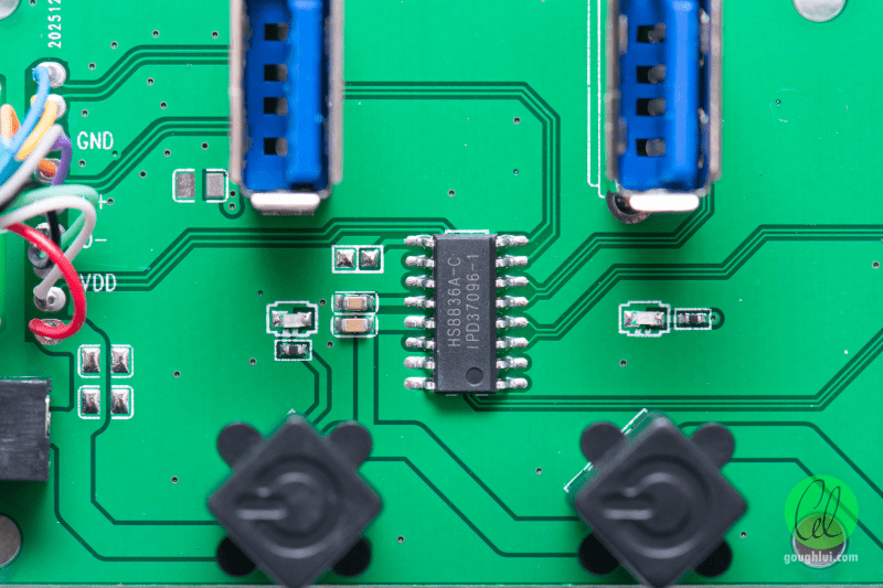

We have a few problem USB hubs ourselves, so it might be worth doing this to any you have lying around. The first clue: most of the connectors on the PCB only have four pins. On closer examination, the hub appears to be a USB 3.0 extension cable with a USB 2.0 hub made from two HS8836A chips.
Not only are these USB 2-only, but all the ports on an HS8836A also share the same USB 1.1 bandwidth. Some hubs can provide multiple ports full 1.1 bandwidth, using the higher-speed USB protocol to the PC as a backhaul.
There were quite a few other issues. Missing solder, cables soldered to the board directly, and no bypass capacitors. The per-port switches cut off USB power, but that wouldn’t stop a device with its own power from connecting. The hub has a barrel jack for power, but it would feed back to the PC, which is bad practice at best.
If you use Linux, try lsusb -t and look at the negotiated speed for your hubs. If they aren’t what you expect, it could be a cable issue, or it could just be that you also have a cheap USB hub. Don’t be surprised if your USB 3 hub shows both a USB 3 and a USB 2 hub; that’s common. But if you only see the USB 2 hub, something is amiss, or someone’s lying.

  4. I noticed this recently on a inexpensive hub; one of the “usb 3” ports is a blue USB 2.0 port. The connector doesn’t even have the 3.0 pins, it’s just a 2.0 connector with blue plastic….
    Somewhere out in aisa there’s a factory making blue usb2 connectors…. 🙄
    1. Nah. Look at it under a microscope. You will see the paint lines. It came from the factory black and they very carefully painted between the pins. That’s why when recruiting for brain surgeons they often hit up the factories. One can learn the medical knowledge but that sort of fine motor control is a gift one must be born with.

    I have the same usb hub, DC plug was dead shorted!
    Also I cannot put my PC to sleep when this thing is connected, it generate bus wakeup pulse instantly.

  8. It also seems to be a crystalless design. Sometimes those work, but I have had a few cheapie hubs which kept dropping the connection.
  9. There are more variants:
    * USB 3.0 connectors with 9 contacts, where the extra 5 contacts are not connected on the PCB.
    * True USB 3.0 hubs where wires of the upstream port are swapped, possibly because of a PCB layout change.
  10. Years ago just when USB3 was becoming available I’d order USB hubs from the great Chinese markets. I got one that was nothing more than a USB port that then replicated to 4 other ports, nothing active in the (transparent!) case. I guess for shared dumb 5v charging it would have worked. Then ordering USB2 hubs would in 100% of cases end up with a USB1 hub. Ordering USB3 hubs ended up with USB2 hubs with blue ports, but a USB2 controller. So to get a free functional USB2 hub I knew I just needed to order the cheapest USB3 hub and when it arrived file for a refund as it wasn’t as described.
  11. I had the exact same issue with the exact same hub.
    didnt bother to pry it open but lsusb was enough for me to notice the scam.
