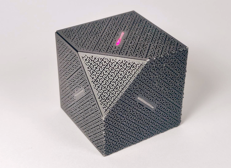

A desktop Borg cube. Just kidding, it's a buttonless, cube-shaped timer with a really neat 3D-printed enclosure.
When you think about it, time is all we’ve really got. Where to go from there is ultimately up to you. Maybe you use an app to track every task, or just go with the onboard timer. But that can be a lot of steps to begin with, and then the phone screen goes dark again. For some people, the whole out of sight, out of mind thing will kick in. At worst, you get distracted, start doing something else, and then feel guilty and frustrated when the timer starts going off.
The guts of FlipBuddy inside the unfurled enclosure.But there’s hope for us visual simpletons, and the purveyor of that hope is [Edris] of Ponderly Robotics. You see, [Edris] created an extremely easy-to-use timer that looks like something you’d find on Captain Picard’s desk as a token of defeating the Borg. But the affably-named FlipBuddy is far more useful than that description implies.
[Edris] uses the open-source FlipBuddy every day, and swears by its simplicity. The point is accessibility, and respect for privacy. That said, there’s a companion app to provide insight.
Basically, you assign a task to each cube face. Choose one, and place the cube with that side facing up. FlipBuddy wakes up, connects to WiFi, and then pushes your session to the cloud, bypassing the need for your phone.
Time to switch tasks? Just put the new side face up. When you’re done for the day, use the stop face, which we’re hoping means to set it on the knocked-off corner.
You don’t need much to make FlipBuddy come to life. [Edris] used an ESP32 (an S3 SuperMini or similar will work), an MPU6050, six WS2812B LEDs, and a 3.7 V Li-Po cell. The beautiful, 3D printed origami mesh enclosure prints as a single, flat piece, and you get to fold it up around the internals and make your new buddy come to life.
Part of the point of FlipBuddy is that it can become as intuitive as punching a chess clock. So if it’s buttons you’re after, check out this simple Pomodoro timer.

      Not a countdown alarm. It is a flip-to-log desk cube: face up = current activity, flip to switch, stop face when done. Goal is seeing where your hours went over days and weeks, not billable timesheets. It always makes me smile when an open source project gets used for something I never planned.
      “Cloud” here just means an optional free companion site/app that stores those face changes for history (+ free AI productivity agent for everyone). Open source firmware/STLs; app is optional if you want more offline / less SaaS.
      Thanks for saying the explanation felt off. I’ll try to make the project page sharper on that.
    1. Thanks! The origami shell + light guides ate a lot of iterations. Glad the guts read as tidy too.
      Aim was a 3D-printable shell with no glue and no screws, so the snap-fit joints had to carry that.
