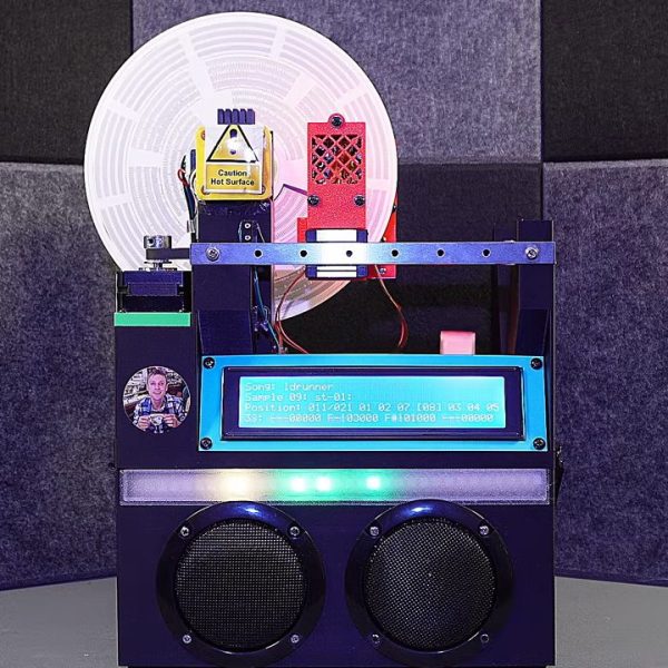

All but a few of our very youngest readers are surely familiar with music formats that rely on optical disks. When we say [RobSmithDev] made a MOD tracker that uses an optical disk, then, you might be forgiven for thinking he stuck a bunch of MOD files onto a CD– MOD files being a format of electronic music that was conceived of on the Commodore Amiga that is still used to this day. A dedicated MOD-CD player might be a fun project, but it’s not what [Rob] did; his project is far more impressive and impractical, as he’s come up with a way to encode the MOD files on paper for optical playback. This way the Amiga’s legacy can be preserved longer than the paltry thousand years promised by the optical M-disk format.

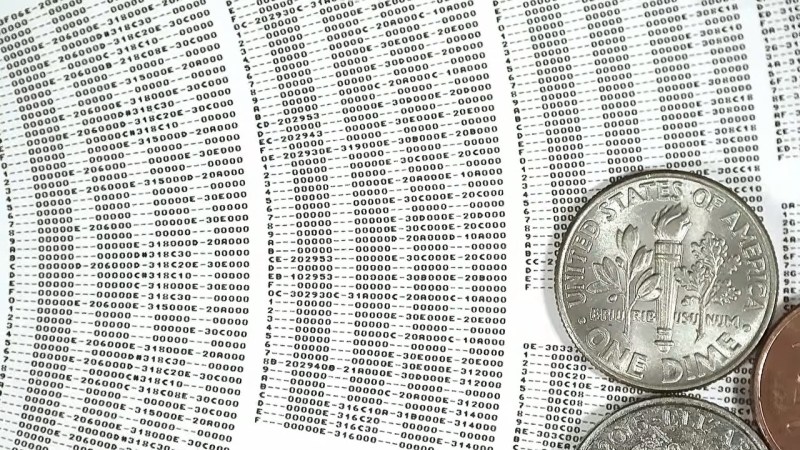

Zooming way, way in on the disk reveals that he’s actually printing the patterns of the MOD file row by row, just like you’d see playing it in a ‘tracker’ program. A MOD file, you see, does not encode music like a WAV or MP3. Rather, like with MIDI, it lists the notes the software reading the file — traditionally called a tracker — is to recreate. Unlike a MIDI file, though, you don’t have to store the same notes more than once: repeating sections are stored in patterns. So most of the disk is just a long list of hexadecimal numbers: several columns worth, one for each ‘voice’ or instrument playing in the song. Another difference with MIDI is that MOD files are self-contained in that they are supposed to contain the samples, which isn’t in evidence until you flip over the disk.
There’s no B-side to [Rob]’s album. Instead a QR-code like series of barcodes is used to encode the samples used in each track on the disk, as well as other information needed to recreate the MOD file, including metadata like title and artist, and the sequencing of the patterns on the front. Of course this means he needs two cameras on his physical mod player, one on each side, and steppers to slide them across the disk like a linear tracking turntable. The front is read via OCR of his modified Amiga “Topaz” font, while the rear holds the first 1084 bytes of the MOD file in a QR-inspired format [Rob] produced specifically for this project.
Unlike the last time we saw someone store music in QR codes, the more modest size requirements of modfiles — something that led to their use in keygens — means this player can store the music’s 8-bit sound samples without the OPUS compression [Rob] is using affecting fidelity. He’s working on another video to give the details of the player– as he works out the bugs, right now it can’t jump betwixt patterns on the disk as fast as some modfiles need–but we’re willing to hazard a guess he’s got a Raspberry Pi in there, and that it’s probably not running the Amiga-inspired AROS operating system.

  1. Just looking at the photo, I have some severe reservations about the data format. Perhaps it’s equivalent to how data was stored in MOD files themselves, but the change in storage medium might necessitate a commensurate change in formatting.
    There doesn’t appear to be any address labeling, or if there is it’s done using marker instructions that have to be interpreted, rather than predictable fixed-size intervals. That seems to imply that seeking within the data stream involves either:
    Fragile relative motions (“begin the pattern located N instructions before/after this one”)
    Absolute addressing relative to some start point (“begin the pattern at instruction X in the file”, or “…starting from marker Y”).
    Which is fine when your data is stored in a random-access file, where you can jump directly to any point as long as you can compute its byte offset (or have an index of marker locations). It’s less fine when you’re dealing with a data stream that can only be read sequentially. Especially if losing your place requires costly position-finding, or if missing a particular instruction requires a full revolution to get back to it again.
    There’s a reason both tape and optical disc favor very linear data streams. And why magnetic disks use large blocks and even larger caches, so that many reads — and ideally all repeated reads — just become memory accesses.

    2. Those are pertinent problems with using this format memory-less, but this is designed as a storage format.
      Most MOD files are a few kB to a Mb so almost anything today has ample capacity to keep the whole file in memory for random access. My i7 laptop processor has 12 MB L3 cache, enough to keep a chonky MOD in SRAM without adverse effects to the OS or other tasks!
      Hardware is awesome these days 🙂
      1. Supposing you could read the code as fast as you can spin it, the disc would need to have a maximum seek time around 10 ms, which means the disc would have to be spinning at 6000 RPM to reach the next random position that is specified in the pattern list.
        1. That said, it’s not possible to do it memory-less because you have to read the samples to memory in advance. Otherwise you’d be reading the pattern from one side of the disc and waiting for the disc to spin to the correct sample to start playing it from the other, but then it would be too late.

    3. How MOD files work, it’s not realistic to play it directly off the disc. It’s too slow. The MOD format contains a pattern list that specifies the order that you play the actual patterns, with repetition, so it can jump backwards and forwards in as little as 10-20 milliseconds depending on the minimum time frame. You have to scan the entire thing, OCR the code, and reconstruct the file in memory.
      1. I wouldn’t think so either, but…
        apparently he’s trying.

  3. To reduce seek times, give it multiple read heads like the floppy drives on the Apple Lisa.
    Maybe optimize placement of the blocks on the disk like they used to interleave sectors on a hard drive.

    Seek times for backtracking probably can be improved by adding better index marks that can be sensed by a simple and fast optical sensor, not by the main camera, and giving some serious power to the main motor.
    It could rip the disk apart but that would be a different problem to solve.
