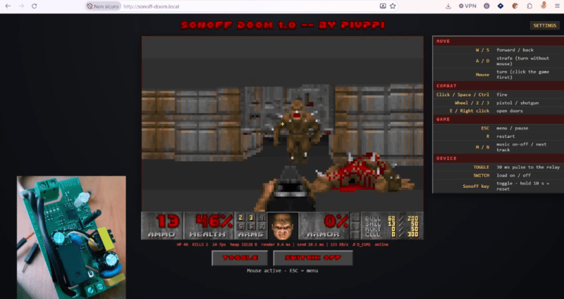

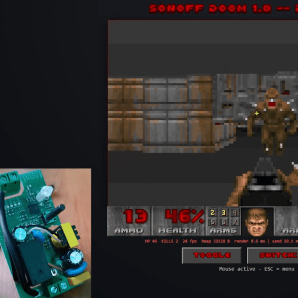

As a perfect example, [piuppi] recently wrote in to share their efforts to get DOOM — or at least something that looks like it — running on the Sonoff Basic R2 smart switch. We say something that looks like it because the game you’re seeing in the video below isn’t actually DOOM. In fact, it’s not even really a full game. It’s essentially a tech demo that’s capable of rendering graphical data pulled from the game, but only within the confines of simplistic map. Still, not bad for something designed to turn lamps on and off.
The GitHub repo includes excellent documentation should you want to rip and tear on your own Sonoff device. As you might expect the process is a bit involved, and does require you to provide your own copy of DOOM for the script to extract the necessary data from. After it’s setup, you can hit the switch from any browser on the local network and take out your frustrations on the state of modern home automation on some imps. The best part is, even after the game is installed and running on the switch, the device still actually works as a switch.

Pretty cool! I might be misunderstanding how it works, but is the Sonoff actually doing the game logic and rendering, with the browser basically acting as the display?
Yep, pretty much :) The game logic and 3D view run on the Sonoff, using its limited RAM, while the assets, including the music, live in the ESP8285’s flash memory. The browser handles the UI, input and playback, but not the actual game engine. Squeezing all of that into an ESP8285 was basically the fun part with opus :)

Haha, thanks! :D Small detail… it’s actually an ESP8285, basically an ESP8266 with integrated flash (1MB) ,…and… hasn’t someone already made Duke Nukem run on a toaster? :)

Yep, AI was part of the process, but getting everything to work on such limited hardware was the fun part. And yes, it’s a custom raycaster, not the original DOOM engine. The challenge was making it work on a Sonoff while keeping its smart switch functionality intact. :)
Very cool hack. What ended up being the biggest limitation on the esp8285; RAM, flash or CPU?
Thanks! :) RAM, definitely. The ESP8285 doesn’t give you much to play with, especially once Wi-Fi is up and running, so every allocation starts to matter.
