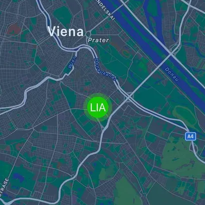

Most commercial pet trackers require a subscription or network connection to function. [Jon G Aguado] wanted a better way and designed LIA, a Meshtastic collar tracker.
LIA uses a custom PCB containing a ESP32-S3, LoRa radio, GPS/GNSS receiver, and a charge controller for the 18650 or 5023450 pouch Li-ion cell powering the device. Everything fits inside a 3D printed enclosure, and the device is charged via a magnetic 4-pin USB pogo connector to increase weather resistance.
One of the neat features of this particular tracker is that [Aguado] gave it two different power modes. High power gets a location fix every 30 seconds and has a pair of bright LEDs for visual assistance, low power only gets a fix every minute or so, and it can also be set to off, which is something we wish more device manufacturers remembered should be an option.
