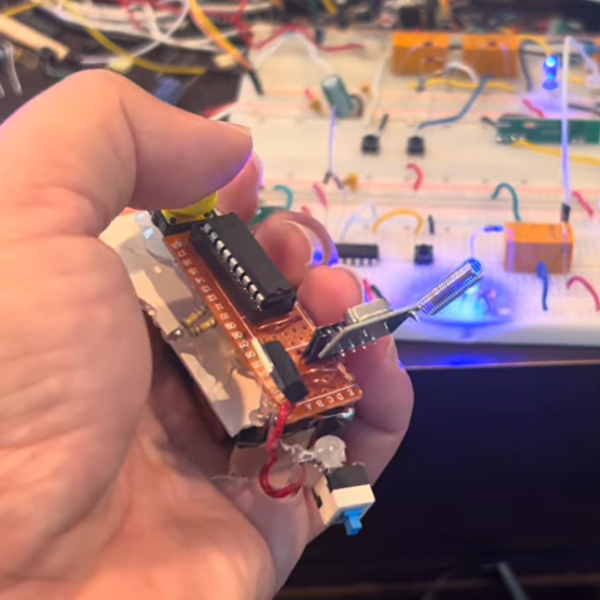

[Igor Brichkov] is demonstrating this project because his garage door remote control suddenly stopped working. The RF receiver and transmitter circuits are readily available and inexpensive, but they need some support circuitry to work properly. The transmitter is paired with an encoder which is provided a binary code by wiring various pins to power and ground. This “code” is sent to the receiver which has a decoder and listens for that specific code. When the codes match it changes the state of one of its pins, which is used in this case to short the garage door’s remote terminals and signal it to open the door.
Although the resulting handheld remote with its single button looks a bit like something from 1950s science-fiction, it’s an effective solution. Especially when compared to possibly trying to reprogram a proprietary remote, find one from a company that doesn’t exist anymore, or rebuild one that operates on a bizarre frequency. With access to the physical hardware, it turns out a lot of things are controlled by just shorting pins together, and anything can do that from wires to RF transmitters.

  1. Quick question to more knowledgeable people than me : I always found RF remotes (433 to 868MHz) kind of big (at least to big to be put on a keyfob). Is this because of the antenna that have a minimum size or just because manufacturer didn’t care about optimizing more? I guess with all fractal antennas nowadays there should be a way to make a RF remote not much bigger than a CR2032 battery no? Is this something any maker/DIYer has been trying to make?
    1. I just bought a pack of three 433mhz radios (SRX882), before realizing I really needed a 315mhz. And then ended up buying a 315 (SYN480R) as well as one that can them all (CC1101). I am here to confirm they can definitely be tiny
    2. They are big because they need to have a battery that has a decent capacity, a low enough IR (to avoid excessive decoupling on the board side) and those particular type of cells are not very small. CR2032 have very high IR.
      Half AA or half AAA are often used with these kind of keyfobs, as far as I’ve noticed.
      1. Thanks for your answer, the internal resistance aspects is something I hadn’t in mind.
        What’s the issue with big IR? Lower shelf life for the remote (battery has to be changed more often)? Something else? If just battery life, is this something than can be solved with a small (super)capacitor?
        Regarding battery replacement, does a self generating solution can help like a Kinetron a piezoelectricity (pinching a quartz to generate enough electricity to enable a MCU to chirp out the code) while staying tiny?
        I’m not sure how small a RF remote can become but I guess (I could be wrong) that the smallest ones on the market are just a good enough solution that hasn’t be challenged nor optimized in years.
        1. High internal resistance in the battery limits the transmit power. A large capacitor in parallel with the battery can help with that, but large capacitors have high leakage which drains the battery. Besides which, large capacitors are large.
          A larger battery has lower internal resistance so the transmitter can be more powerful. The larger battery lasts for years because it has a larger capacity, so you don’t have to change it often.
          The remote control for the garage door usually stays in the car rather than your pocket, so no problem there.
          1. Ok so the solution would be to use either self generating solution as mentioned, or find a small battery with chemistry that would provides low IR. Food for the though, I’ll see what is available on this side, thanks!
            The garage door remote is on a keyfob in a pocket if said garage only contains bikes ; )
    1. Yeah mine is a keyfob but it’s like 1cm (1/2″) thick and 4x3cm (~2×1″) so too big for my taste. It seems that 433MHZ SMD antenna are a thing. I wonder if it would be possible to mod an existing programmable 433mhz fob to use such an antenna instead of a big coil.
      As it’s a stupidly simple idea and I don’t see anyone trying it I guess there’s a gotcha somewhere. A RF remote as thin and light than a regular key would be awesome.
