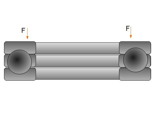

        1. These take no radial forces at all. Imagine a shaft taking a huge axial load this might be used in combination with two cylindrical roller bearings (albeit I don’t think such will be designed that way very often).

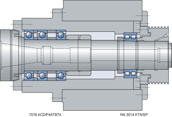

          lathe bearings are normally build something like that:
          http://www.skf.com/binary/49-116209/1212%200003%20-%2013383%20w_tcm_12-116209.png
          the three left side bearings take both radial and axial forces, two for one direction and one for the other direction (that has less load). On the right side, the driven side, only radial forces are handled. from the design pattern it follows the essentiale rules: on side is fixed (can not move in any direction) and the other side if free in one direction (can make length movements) to compensate heat related length changes. See “degress of freedom”, best seen on bigger bridges.
          The lathe design depends on the principles that under load one of the left bearings is compressed a tiny little bit so its load is distributed to the other one, too.
