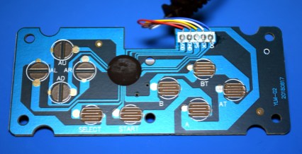

This system is one of the ones that comes bundled with an external controller, and while I can’t quite fathom a scenario in which it might be useful, I’ll admit that the input device was intriguing. It’s a bit small, but I liked the buttons and it felt reasonably solid in the hand. But what really had me interested was the fact it connected to the system’s USB port. Could it actually be a USB HID device?
But another black blob and the wiring would seem to suggest otherwise. The trio of communication wires made me think it was using some form of SPI, but when I connected the logic analyzer to confirm this, I found all the lines dead. Indeed, the system doesn’t seem to acknowledge the presence of the controller at all, and nothing in the manual explains if there is something I have to do to actually enable it other than plugging it in. Certainly something to keep in mind if you were excited about this particular feature.

I wouldn’t be surprised to see that the controller uses the same control scheme as the original classic NES controller. Just a 8-Stage Static Shift Register (4021) – that’s all that it needs.
NES controller needed 5 lines: 5v, ground, clock, latch, and data. Unless the USB plug got creative and used the shell for ground and all 4 pins for the rest, it is not a NES controller clone.
There could be ways to combine the latch line with clock or 5v.
Given the silkscreen labels on the controller PCB, I strongly suspect that the controller part is a classic pseudo-SPI NES controller. The other side looks like it’s USB mini-B, which does have 5 pins.
The controller DOES work. PS=Pin Sample(latch) I’ve build a USB Controller with this and a CH552.
USB mini and micro have 5 pins
No one noticed that there are 12 buttons on the case, but only 10 on the controller’s PCB?
Yes, and they don’t work, along with the rest of the controller!

I have one of these clones. The extra controller works with the 2 player roms such as tetris.

Wonder if the controller is only for the second player in two player games? Then… no signals, normally…

Controller wire is the same with most Famiclone controller (Vcc Gnd Latch Clock Data). Can anyone use it as monitor?
Hi, do you how it’s connected on the micro USB? I want to do at my self, because i hace one of this famicom fake consoles controller.
Hi, can anyone give me the pinout of the controller on the micro USB, i want to do my own controller because i don’t want to spend money on a controller, i own a fake famicom controller and it has the same pinout, but i don’t know the pinout on the micro USB and i need someone to tells me how it’s, thanks, i really apreciate
