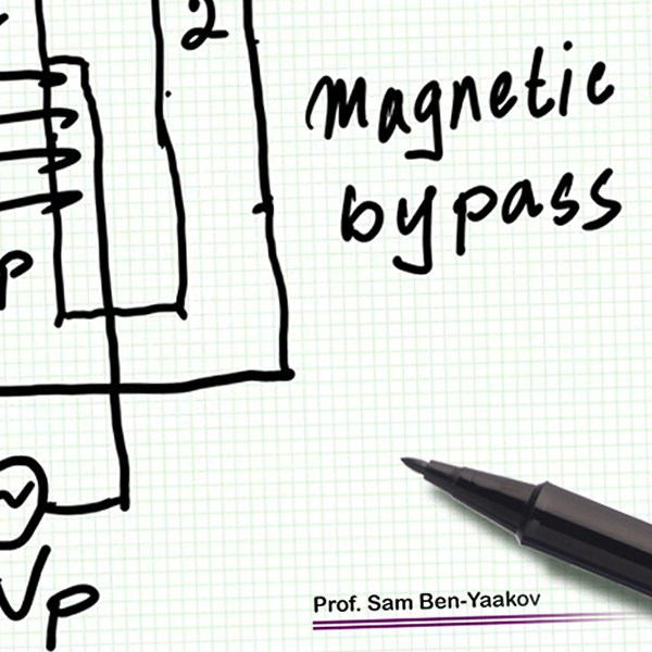

If you think shorting a transformer’s winding means big sparks and fried wires: think again. In this educational video, titled The Magnetic Bypass, [Sam Ben-Yaakov] flips this assumption. By cleverly tweaking a reluctance-based magnetic circuit, this hack channels flux in a way that breaks the usual rules. Using a simple free leg and a switched winding, the setup ensures that shorting the output doesn’t spike the current. For anyone who is obsessed with magnetic circuits or who just loves unexpected engineering quirks, this one is worth a closer look.
So, what’s going on under the hood? The trick lies in flux redistribution. In a typical transformer, shorting an auxiliary winding invites a surge of current. Here, most of the flux detours through a lower-reluctance path: the magnetic bypass. This reduces flux in the auxiliary leg, leaving voltage and current surprisingly low. [Sam]’s simulations in LTspice back it up: 10 V in yields a modest 6 mV out when shorted. It’s like telling flux where to go, but without complex electronics. It is a potential stepping stone for safer high-voltage applications, thanks to its inherent current-limiting nature.

        1. Sort of, but different.
          Without load, there is not much difference. Either with or without the magnetic shunt, the current will be low. The big difference is under load. Without the shunt, all the manetic field goes though the secondary winding, and induces a voltage / current. But with the magnetic shunt, a part of the magnetic field will go though the shunt, and as a result, the primary winding will always have some magnetic “resistance”. I only saw a few short sections of the video above, but it seems to explain this in more detail.
          This is most extreme when the secondary winding is shorted. Without the shunt the transformer will saturate, overheat and start smoking. But with the shunt, the primary current is limited, because there is always some magnetic field through the shunt.
          So, from no load to maximum load current, the secondary voltage will start sagging. In mircowaves this is used as a stabilization mechanism. At a certain load the power to the microwave tube will be stable.
          This is also used a lot in MMA welding transformers. In this case the magnetic shunt is made moveable, to adjust the welding current (under typical welding voltage conditions).
