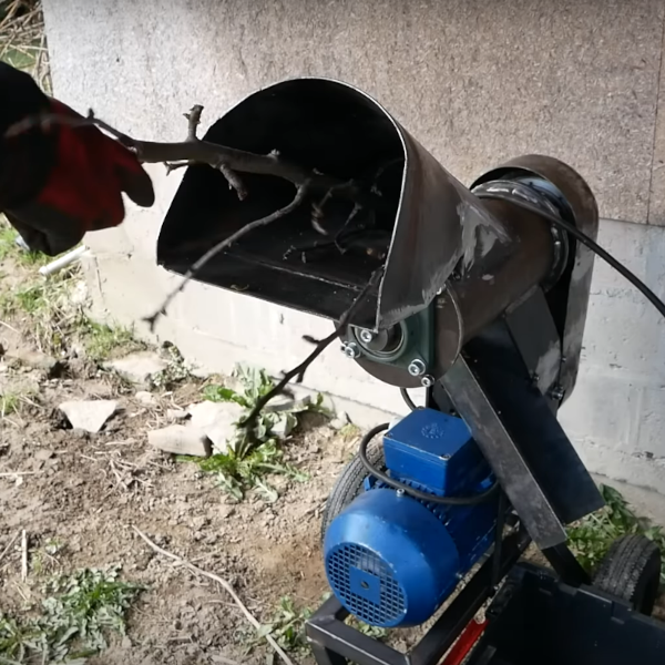

For whatever reason, certain pieces of technology can have a difficult time interacting with the physical world. Anyone who has ever used a printer or copier can attest to this, as can anyone whose robot vacuum failed to detect certain types of non-vacuumable waste in their path, making a simple problem much worse. Farm equipment often falls into this category as well, where often complex machinery needs an inordinate amount of maintenance and repair just to operate normally. Wood chippers specifically seem to always get jammed or not work at all, so [Homemade Inventions] took a shot at building one on their own.
To build this screw-based wood chipper, the first thing to fabricate is the screw mechanism itself. A number of circles of thick steel were cut out and then shaped into pieces resembling large lock washers. These were then installed on a shaft and welded end-to-end, creating the helical screw mechanism. With the “threads” of the screw sharpened it is placed into a cylinder with a port cut out to feed the wood into. Powering the screw is a 3 kW electric motor paired with a custom 7:1 gearbox, spinning the screw at around 200 rpm. With that, [Homemade Inventions] has been able to easily chip branches up to 5 centimeters thick, and theorizes that it could chip branches even thicker than that.

    Flattening the sides of that pipe @06:52 seems to go quite well, but at 07:04 the part is suddenly made out of 3 pieces.

    1. Can’t see it, but it’s in the intake.
      The main problem with this is the wear parts are the chipper housing and screw.
      Doubt they are even hardened.
      He really should have taken a good look at the standard(s) before going off on ‘first principles’.
      Also what is the point of exposing three full turns of the screw?
      It’s only going to cut at the bottom.
      The screw spacing effectively limits this to cutting small branches.
      Also: Chain drive? No Flywheel?
