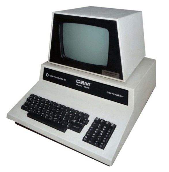

Over on his blog our hacker [cpt_tom] shows us how to simulate the hardware for a Commodore PET. Two of them in fact, one with static RAM and the other with dynamic RAM.
This project is serious business. The simulation environment used is Digital. Digital is a digital logic designer and circuit simulator designed for educational purposes. It’s a Java program that runs under the JVM. It deals in .dig files which are XML files that represent the details of the simulated hardware components. You don’t need to write the XML files by hand, there is a GUI for that.
This digital simulation from [cpt_tom] is based on the original schematics. To run [cpt_tom]’s code you first need to clone his GitHub repository: https://github.com/innot/PET-Digital-Simulation. You will need to install Digtial and configure it with the PETComponentsDigitalPlugin.jar Java library that ships with [cpt_tom]’s code (the details are in the blog post linked above). If you want to go deep into the PETComponentsDigitalPlugin.jar rabbit hole see Sim6502Java and PETComponentsPlugin.
What’s not in the documentation is that you will need to update the paths to the binaries for the ROMs. This means searching in the .dig XML files for “C:\Users\thoma\Documents\Projects\PET-Digital-Simulation” and replacing that path to whichever path actually contains your ROM binaries (they will be in the code from GitHub and have the same directory structure). This simulation is complete and the hardware components defined can actually run the binaries in the emulated ROMs.
