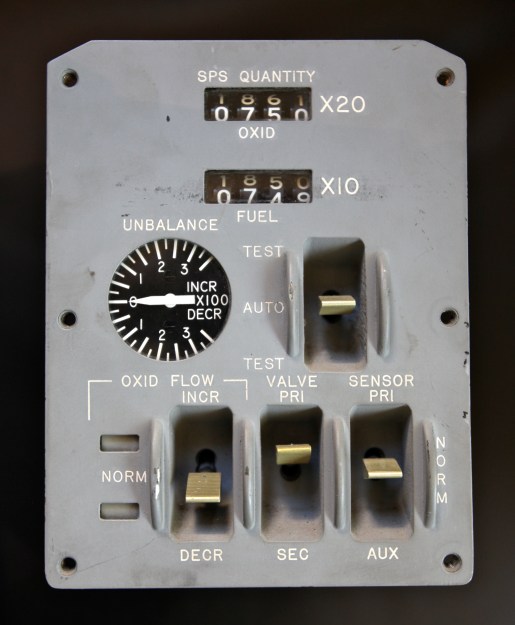

Propellant Utilization Gage Subsystem (PUGS) display from an Apollo Command Module. This is an early version that totals fuel and oxidizer in pounds rather than displaying the percent remaining. The dial indicates if fuel and oxidizer flows become unbalanced. Source: Steve Jurvetson, CC BY 2.0.
Monitoring pee on a space station may be important, but keeping track of propellants during crewed flights is a matter of life or death. During the Apollo missions, a variety of gauging methods were employed for fuel and oxidizer measurements, most of which relied on capacitance probes inside the tanks. The Apollo service module’s propulsion system used the Propellant Utilization Gauging Subsystem, or PUGS, to keep track of the fuel and oxidizer levels onboard.
PUGS relied primarily on capacitive probes mounted axially within the tank. For the fuel tanks, the sensor was a sealed Pyrex tube with a silver coating on the inside. The glass acted as the dielectric between the silver coating and the conductive Aerozine 50 fuel. In the oxidizer tanks, the inhibited nitrogen tetroxide acted as the dielectric, filling the space between concentric electrodes. Once settled with an ullage burn, the level of propellants could be determined by measuring the capacitance across the probes, which would vary with liquid level. Each probe also had a series of point contacts along its length. Measuring the impedance across the contacts would show which points were covered by propellant and which weren’t, giving a lower-resolution reading as a backup to the primary capacitive sensors.
For the Lunar Module, propellant levels for the descent stage were monitored with a similar but simpler Propellant Quantity Gage System (PQGS). Except for an initial ullage burn, fuel settling wasn’t needed during descent thanks to lunar gravity. The LM also used the same propellants as the service module, so the PQGS capacitive probes were the same as the PUGS probes, except for the lack of auxiliary impedance-based sensors. The PQGS capacitive readings were used to calculate the percent of fuel and oxidizer remaining, which was displayed digitally on the LM control panel.
