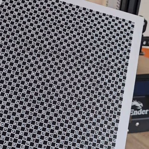

If you want to put [Marius Wachtler]’s solution to work for you, it’s probably best to review his earlier work on pressure-advance correction. The tool-mounted endoscopic camera he used in that project is key to this one, but rather than monitoring a test print for optimum pressure settings, he’s using it to detect minor differences in the X-Y feed rates, which can turn what’s supposed to be a 90-degree angle into something else.
The key to detecting these problems is the so-called ChArUco board, which is a hybrid of a standard chess board pattern with ArUco markers added to the white squares. ArUco markers are a little like 2D barcodes in that they encode an identifier in an array of black and white pixels. [Marius] provides a PDF of a ChArUco that can be printed and pasted to a board, along with a skew correction program that analyzes the ChArUco pattern and produces Klipper commands to adjust for any skew detected in the X-Y plane. The video below goes over the basics.

    And Bob asked why it’s not on your system, skew correction is in klipper but the camera integration in the tool head is generally lacking on a lot of machines, hence the project maker using an endoscope, so this will add a framework to allow this for anyone. Generally skew correction is as described in the video, do a test print, measure some things, do some math, punch the numbers in to klipper/the slicer and you’re done. It just depends on the slicer or firmware that you’re using on the machine.
