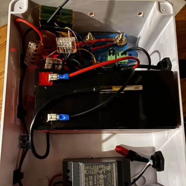

If you put a bunch of computers in charge of your house, it’s generally desirable to ensure their up-time is as close to 100% as possible. An uninterruptible power supply can help in this regard. To that end, that’s why [Bill Collis] whipped one up for his Home Assistant setup.
[Bill]’s UPS is charged with one job—keeping the Home Assistant Green hub and an Xfinity XB7 cable modem online when the grid goes dark. The construction is relatively straightforward. When the grid is up, everything is powered via a Mean Well AC-DC 12 V power supply, while the power is also used to charge a 12.8 V 10 Ah lithium iron phosphate battery pack. When the grid goes out, the system switches over to running the attached hardware on pure battery power. A Victron BatteryProtect is used to automatically disconnect the load if the battery voltage drops too low. Meanwhile, a Shelly Plus Uni module is used to monitor battery voltage and system status, integrated right into Home Assistant itself.

    I have made a DIY UPS for my raspi zero 2W server though, with a 4Ahr lithium cell. It has auto switchover and its incredibly robust, despite being made from a TP4056 module, a boost converter and a single AO3401 FET. It can charge the cell while also powering the board (battery is disconnected, in such a case). Whenever power goes away, it immediately uses the cell to make 5V
    1. you can buy what you built for 99 cents on Ali. little modules that take two 18650 and offer 5, 9 or 12V output. they include charge control and discharge protection
  2. you can buy 12V UPSs for less than the cost of the wagos used in this project. you can get them “straight to mains” with uninterruptible 12V output, or as PCBs with USB-C input and 5-9-12V outputs (these cost 99 cents on Ali)
    one really needs to choose battles properly and hacking something together for $100+ providing no real benefit over a $20 solution is just silly.
    1. Sure but his setup will keep him online twice as long and probably last a decade or more before he needs to buy a new battery. Then it will be like new after that. The rest of the device could outlive him.

  4. https://www.tztstore.com/goods/show-8155.html – this is a more simple solution. as this is connected in parralel with the psu and the load. It runs on 3s Li-Ion packs. The only caveat is that you need to adjust the PSU output voltage to 12.8v to achive 100% SOC on the pack. I’m running a mini pc, router and security camera on the same 12v “bus” and it had zero issues.
