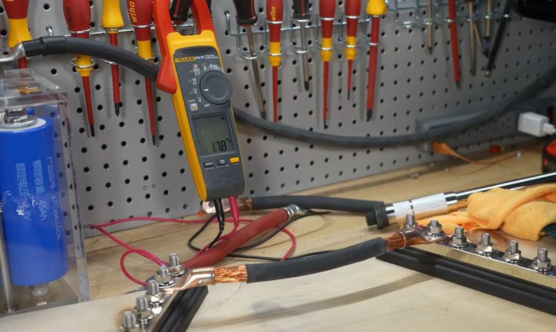

For some reason there’s heated debate around the topic of whether high current carrying wiring ought to use crimped or soldered connections, even though the industry standard is to crimp everything. As a practical demonstration of why this is the case, [Will Prowse] set up a test involving a rig capable of dispensing a few hundred amps through both a crimped and a soldered copper cable.
Prior to making things go spicy, [Will] made sure to check the resistance of the two cables, noting that the soldered version had significantly lower resistance than the crimped connectors. This could be one metric that proponents of soldered connectors can point to as a benefit.
Of course, the main benefit of crimping is that you create a cold weld if crimped properly, which is a sold-state welding process that effectively blends two metal surfaces together. This is also why wire wrap is generally considered to be so very reliable, as it creates a gas-free, solid connection that does not rely on a softer, dissimilar material like solder to hold things together. Of note here is also that the cold weld process tends to continue for a while, so this kind of connection is likely to get better over time.
In the subsequent testing this difference is demonstrated quite well, especially when both cables are subjected to the sort of mechanical abuse that would be expected in an installation, such as vibrations and direct impacts. Here the soldered connections quickly begin to fail, resulting in one soldered connector even unsoldering itself due to heat development. Ultimately cold welding is simply superior over relying on a flimsy and capricious interface of intermetallic compounds.
So what’s the takeaway? Solder and crimp? How’s about solder then crimp (cold weld) as your ai article calls it…

I would recommend cutting open one of your connections. If you’ve crimped it properly you’ll notice that there is no solder in it at all. The solder just goes around everything.

You guys ever cut one open to see how far the solder actually goes
ive more than once dipped a stripped wire in flux and wrapped it with solder solder before crimping and blasting it with hot air. probibly substandard but i only did it because the crimp was too big for the cable. im a shut-in so id never use it on a vehicle.
your crimp’s are only as good as your crimping tools. everyone knows that crappy stamped sheet metal crimper with the red handles, its in every toolbox, and not useful for a single thing. i also got a dupont crimper that seems to be substandard, though im not sure if its a fault of the crimp pins, the tool or the operator. i usually opt for soldered on the grounds that am poor and only can afford crappy tools and crimps.
Yep. Done lots of crimps for small EVs (200 – 500 A) and my hand hydraulic crimper works miracles. Without it I can’t imagine connections surviving mile after mile of heat and vibration.

Crimping does not create a cold weld, and if air/water invade the join, corrosion and high resistance result.
Electricians commonly use a conductive paste on joins to exclude air/water. A soldered join is a reliable join.
Crimping does create cold welding, but you usually only see it in large crimps done with a decent tool, like 8mm plus and a crimper with foot long lever arms which require dozens of kilos of pressure to actuate. Cut one of those crimps open and you’ll find most of the copper has become a solid block.
Mine is a 10 ton hydraulic crimper.
As you say, cut open a crimp and the copper is a block.
To the best of my knowledge, the paste that electricians use is there to prevent oxidation and other forms of corrosion, particularly if aluminum is involved.
Any conductive paste that could flow over time would be a hazard.
