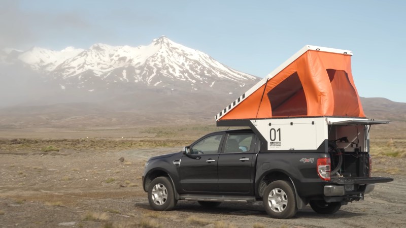

A black pickup sits in front of a snow-capped mountain range in the background. It has a white camper shell with a sci-fi looking "01" emblazoned on the side in black text. An orange, wedge-shaped tent pops up above the campershell and truck roof.
We live in a veritable Cambrian Explosion of camping options, ranging from a tarp on the ground to multi-million dollar RVs. Somewhere around the middle is the pop-up truck camper, but [Further Fabrication] wanted to build his own.
As is often the case, he saw the cool pop-up truck campers on the market, but balked at the cost. To make matters worse, the options out there weren’t really available in his country. After getting a solid set of measurements from the truck and some materials, he set to work.
The most interesting part of this build is probably the aluminum/plywood sandwich [Further Fabrication] chose for building the main structure of the camper shell. While many would’ve chosen a tubing space frame for the build, he decided to sandwich two layers of plywood around plywood beams and large rectangular aluminum tubing. These were affixed with a combination of construction adhesive and screws to create a lightweight yet sturdy enclosure.
The tent portion uses a 600-denier PVC-coated waterproof polyester fabric, sewn with nice YKK zippers, and features large windows with screens for excellent ventilation. The roof consists of two sections of aluminum composite sandwich, and the side panels were made from cutoffs of the roof material. Instead of the standard cam-lock used on most camper shells, [Further Fabrication] chose a solenoid-actuated system and more conventional grab handles.

  3. The build seems to be plenty strong, but I wonder a bit how much of the strength comes from the hollow aluminum struts on the inside. Mostly as the metal pieces are only connected to wooden pieces, but not to each other. I expect it’d be just as strong to build a metal frame and add wood to the outside of the metal frame.

    But that plywood aluminum sandwich is pretty dumb. All the downsides of both, with none of the upsides. Might as well have been all plywood and been just as heavy for way less work. Or put in the same work to make it all aluminum and don’t worry about rot or soaking up water.
