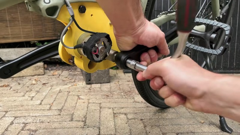

[Pedro Neves] has a mid-drive e-bike, but he doesn’t own it — not truly, since he can’t repair the motor unit. For a hacker to be in that position, there are only two options: crack the old one and make it your own, or build your own from scratch. [Pedro] built his own and is open-sourcing it on his website for everyone to play with. Right now, that’s .step files and a BOM, so you’ll need to watch the design/build video on YouTube below to get the full picture.
His choice of a motor from an old battery-powered angle grinder is both thrifty and environmentally friendly, so we approve. His goal of 25 km/h seems like a reasonable speed limit, but may still be too fast for some countries’ regulations— so do check the local rules if you’re going to build this. Making the most of 3D-printed components is also a choice that makes the project more accessible, but don’t worry — the bearing surfaces are all metal. That includes the clutch bearing that will let you pedal home if the battery dies or the motor craps out. Well, unless the printed plastic axle gives up the ghost, but that got replaced with a CNC version, so it’s all good. Unless you’ve got legs like Hercules, it ought to hold.

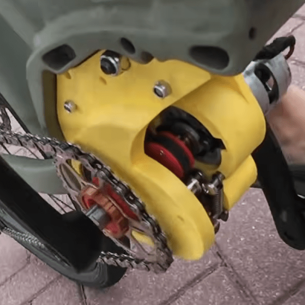

    Dude made the most ridiculous mid-drive using a generic low-torque brushed motor and some 3d printed parts which will fall apart as soon as that video ends.
    We live in times where we have affordable opensource bldc drivers like VESC, and there are VESC-based mid drive kits. There are myriads of DIY designs for vesc head units, which require no more than an esp32 and half-a-brain.
    Last time I’ve seen a brushed motor powered transport, was one of those cheap 800w quads for kids. At least those had some torque and speed, comparing to this abomination.
    It really triggers me when someone gets praised for reinventing the wheel(sometimes literally) for the 100th time in the worst possible way.

  4. for real though that plastic is in the load path?? bottom brackets are not a place where you can skimp on tension strength

    Looking at the results the angle grinder motor wasn’t a good choice mainly because it’s designed to be high revving and would need quite a lot of cogs to get an output speed of around 80rpm peddling speed from a motor spinning at around 25,000 rpm. Gearing on an angle grinder I’d guess would be a reduction of about 3 to 1 for a typical cordless angle grinder with a disc speed of 8000 rpm. So that motor would require a reduction ratio of at least 250 to 1 which would make it very noisy. I’d suggest getting an escooter motor which being bigger and much lower revving could be feed through a planetary gearbox to the pedals. As for the home made clutch. It is subject to too much force to be able to use plastic on that diameter of shaft. I personally would get a rear bike wheel and use the freewheeling sprocket with a chain or toothed pulled to achieve the drive from the electric motor and the sprocket would allow the bike to be peddled without spinning the motor when not using the motor. Also something that would be of a SAFETY concern is the design using plastic to hold the peddle assembly onto the bike frame. If one was to stand up to peddle whilst going up hill and it broke off that could result in a nasty accident.
    1. The entire project is a travesty. Starting off with a 3d-printed bottom bracket spindle is unbelievably stupid– there’s a reason they’re made from hardened steel.
      Then there’s the choice of a severely under-powered motor, running what looks like a single-stage reduction gear on the bottom bracket spindle, and he’s wondering why it burnt out!? The guy’s running on vibes and not even running the numbers. At least Tom Stanton does.

        1. For one thing, even the cheapest ebike kits with brushed motors start at 24V 250W. Yet somehow he thinks a puny 12v motor can propel his reverse tricycle, hopefully to 25 km/h? Get real. I’d call what he’s doing “vibe engineering”.

  6. That tiny brushed motor probably couldn’t propel an RC car to 25km/h much less a bicycle with a heavy sack of human flesh sitting on it.
