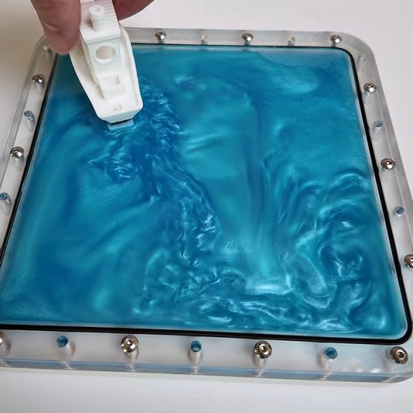

[Visual Thinker] isn’t starting with serious simulations; the first thing he tries is essentially a toy that lets him see fluid flow around a Benchy by sticking magnets in it and using it to move a cross-section of its hull though a thin layer of fluid sandwitched betwixt pieces of laser-cut acrylic. We don’t call it a toy to disparage it, though– we totally want one. [Visual] mentions the idea of a coffee table combining the concept with the kind of underslung mechanism we see in sand drawing tables, which sounds dangerously hypnotic. If any of you build one, please try and tear your eyes away long enough to let us know.

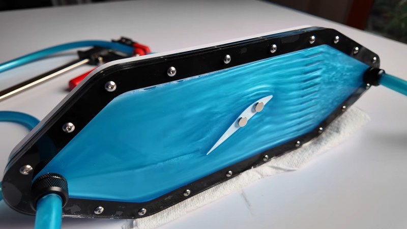

He has another beautiful piece that make the video worth watching: a wind-tunnel, again made of laser-cut acrylic and printed parts. With careful consideration of the scale and flow speeds, that one might actually prove useful– and even if it doesn’t, it’s pretty enough that it doesn’t really matter. Beauty has its own utility sometimes.
Most wind tunnels we see around here use actual wind, but rheoscopic fluid was invented for this sort of thing, even if it does make for pretty baubles.

I wonder if/how it handles flow separation? Can one use multiple outputs to experimentally determine flow vectoring perhaps, or perhaps hall effect sensors or variably aligned transformers to determine lift? So many possibilities to make this vaguely more quantitative.
Usually in wind tunnels, lift is measured with load cells on the wing profile supports. And flow separation will certainly happen, with the appropriate Reynolds number and angle of attack. What would there be to “handle” ?

Now if you do make a coffe table, you want to use ferromagnetic flakes, no? To draw patterns/reactions without opening it each time.
If you could find ferromangetic flakes that could stay suspended, that would be a cool way to do it ! I can’t think of a substance that flakes like mica and is ferromagnetic, though. The coffee table idea would be like a sand table– they don’t use magnetic sand that I have seen, instead the the underslung magnet is moving a ferromagnetic object inside the medium to act as a stylus/stirrer.
You want magnetos viewing film. Micro capsules of basically MagnaDoodle
