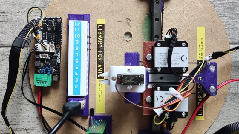

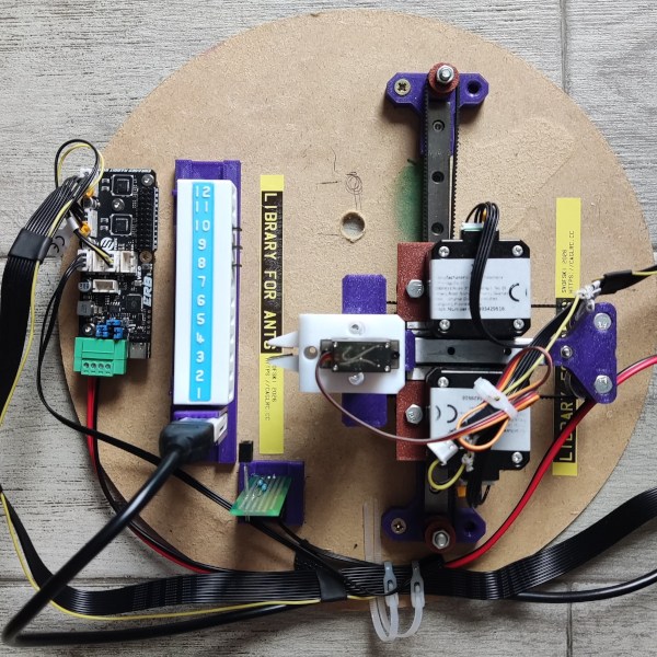

The library is based around a tiny robotic arm that can physically grip the cards and move them in and out of a reader. The first iteration of the arm involved rotating the two pincers, but this turned out to be overly complicated and [svofski] eventually settled on a design resembling a rack and pinion that slides the two pincers together instead. With the gripper sorted out, it’s placed in system called T-bot arrangement, similar to coreXY kinematics, that lets it pick and place among 12 microSD card slots.
Many of the parts in this build were directly from or inspired by 3D printers, making it relatively simple with so many parts available. [svofski] didn’t build it for a specific use case, though; mostly it was constructed out of fascination for robotic tape changers which perform a similar function. But for anyone who actually needs to duplicate a large number of SD cards, or other types of removable media, this could prove to be a fairly handy robot.

    1. A card can be identified by sticking it into the reader and reading its disk label.
      microSD cards are really small. Consider that the gripper also holds the card by its edge, thus covering part of its minuscule surface. There’s not that much area left to write on.
      In addition to barcodes I considered other ideas as well:
      – using a camera to just oversee the storage bay and detect which cards are present in storage
      – adding reflective dot patterns to the edges of cards, so basically a micro-barcode of sorts
      – shooting IR light from behind the storage bay and detecting cards by blocked light
      But simply picking a card and bringing it to a reflective sensor does the job and looks fun, so it won. I think the other methods are also interesting to try, but implementing them could have extended the project time indefinitely. To be honest it already took much longer to complete than I anticipated, even without advanced features.
      Let’s see if it inspires others to build a more robust and feature-rich microSD card library.
