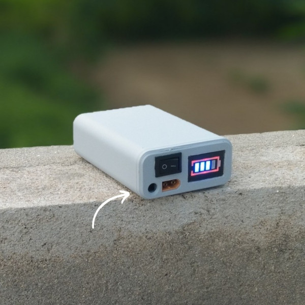

Part of why this project from [Next Builder] works so well is that most off-the-shelf routers don’t actually use that much energy. Keeping that and a modem online when the power is out only requires a few lithium batteries. To that end, three lithium ion cells are arranged in series to provide the router with between 9 and 12 volts, complete with a battery management system (BMS) to ensure they aren’t over- or under-charged and that they are balanced. The router plugs directly into a barrel jack, eliminating any switching losses from having to use an inverter during battery operation.
While [Next Builder] is a student who lives in an area with frequent interruptions to the electricity supply, this does a good job of keeping him online. If you’re planning for worse or longer outages, a design like this is easily adapted for more batteries provided the correct BMS is used to keep the cells safely charged and regulated. You can also adapt much larger UPS systems to power more of your home’s electrical system, provided you can find enough batteries.

  1. This is just a 3S lithium battery, not a UPS. There’s no voltage regulation, charger or circuitry to transfer between mains and battery power. Lithium ion batteries are also terrible for UPS use since they hate being kept at full charge.

  3. 1) It supplies 9-12V to the router & modem?!?! While I’m not surprised that the router and modem can function off of 9V, this seems rather bold to design this “UPS” without regulating the output to the 12V the devices officially require. I think it would have been much better to add a couple cells to bump up the battery voltage range, then use a simple & efficient buck converter to step that down to a constant 12V output.
    2) If it is determined that the router & modem are happy running off 9-12V, a much simpler design could simply be a small 12v lead acid battery in parallel between the devices and the 12V power supply. The 12V power supply would keep the battery charged to 12V, and supply 12V power to the devices. If a power outage occurs, the 12V power supply will no longer supply power but the battery will – no fancy switching circuitry required!
    The ideal battery is a ubiquitous/universal SLA deep-cycle battery – they are cheap, available in tons of sizes, and there’s a reason why they are used in UPSs, building alarm system backup power, emergency lighting, etc.

    That thing in the image above would power those very very shortly.
  8. I was thinking about something similar recently. My router runs at about 10W average, each 18650 stores about 3500Mah at 3.7V or about 10Wh, so 3 of them would keep a router alive for 3 hours max, maybe long enough for electricity to return. I considered an old Android phone running as a hot-spot as alternative backup, but it only works as long as the local cell phone masts stay alive (typically 1-2 hours).
