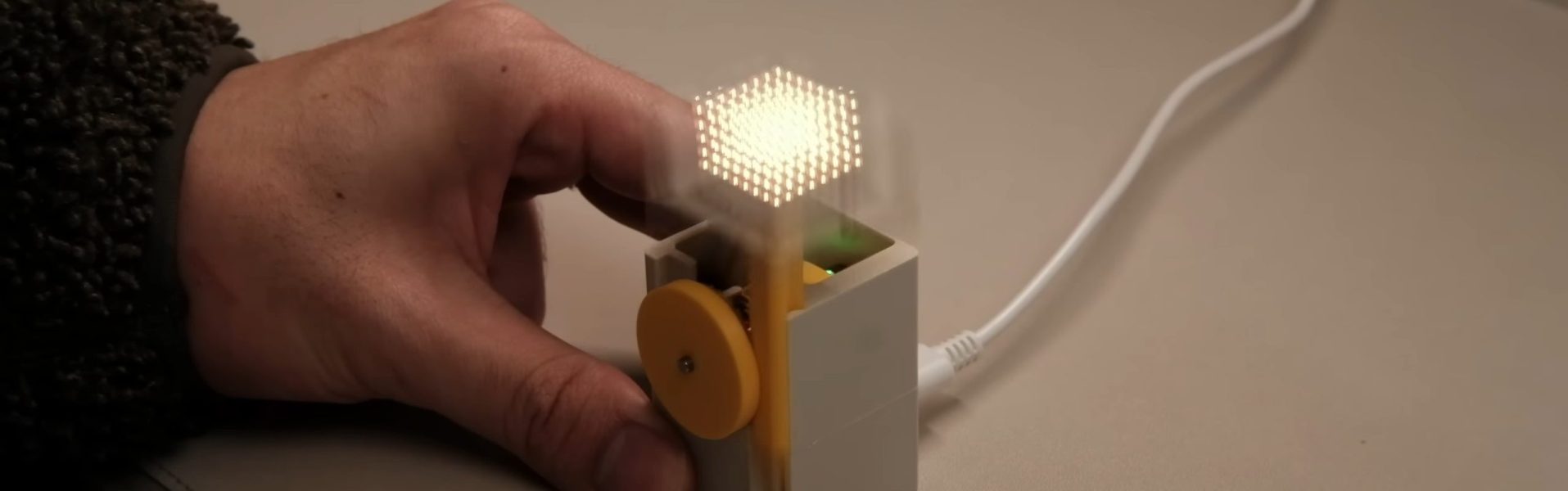

There’s something delightfully sci-fi about any kind of volumetric display. Sure, you know it’s not really a hologram, and Princess Leia isn’t about to pop out and tell you you’re her only hope, but nothing says “this is the future” like an image floating before you in 3D. [Matthew Lim] has put together an interesting one, using persistence-of-vision and linear motion.
The basic concept is so simple we’re kind of surprised we don’t see it more often. Usually, POV displays use rotary motion: on a fan, a globe, a disk, or even a drone, we’ve seen all sorts of spinning LEDs tricking the brain into thinking there’s an image to be seen. [Matthew’s] is apparently the kind of guy who sticks to the straight-and-narrow, on the other hand, because his POV display uses linear motion.
An ESP32-equipped LED matrix module is bounced up by an ordinary N20 motor that’s equipped with an encoder and driven by a DRV8388. Using an encoder and the motor driver makes sure that the pixels on the LED matrix are synced perfectly to the up-and-down motion, allowing for volumetric effects. This seems like a great technique, since it eliminates the need for slip rings you might have with rotary POV displays. It does of course introduce its own challenges, given that inertia is a thing, but I think we can agree the result speaks for itself.
One interesting design choice is that the display is moved by a simple rack-and-pinion, requiring the motor to reverse 16 times per second. We wonder if a crank wouldn’t be easier on the hardware. Software too, since [matthew] has to calibrate for backlash in the gear train. In any case, the stroke length of 20 mm creates a cubical display since the matrix is itself 20 mm x 20 mm. (That’s just over 3/4″, or about twice the with of a french fry.) In that 20 mm, he can fit eight layers, so not a great resolution on the Z-axis but enough for us to call it “volumetric” for sure. A faster stroke is possible, but it both reduces the height of the display and increases wear on the components, which are mostly 3D printed, after all.
