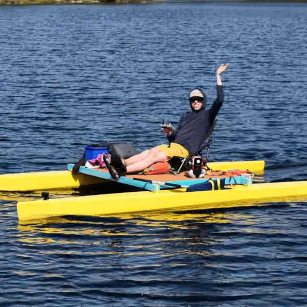

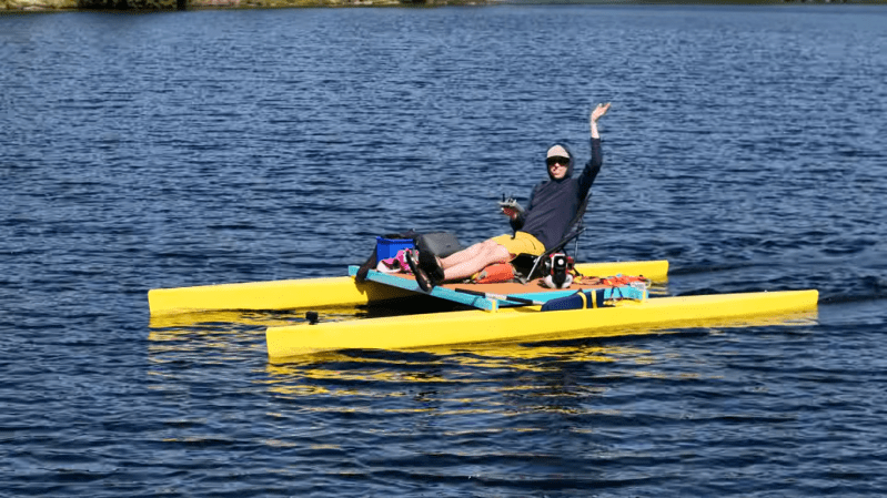

Offloading acceleration and braking to an electric motor in a hybrid configuration allows the less efficient combustion engine run in a more narrow set of RPM and torque ranges. In some cases the motor is decoupled from the mechanical drivetrain entirely and used simply as a generator, where it can run at a single speed all the time. And this concept isn’t limited to passenger vehicles, either. [rctestflight] put this premise to the test using a small knockoff Honda motor as a generator for an electric boat.
This project builds on a previous version where he used a much smaller hobby motor to see if it could generate usable power, and that system powered a small autonomous boat as a proof-of-concept. Those motors aren’t really designed to be used in this sort of application though, so this build upgrades the internal combustion engine and pairs it with an electric skateboard motor that’s configured to run as a generator. The setup is capable of producing almost 800 watts for as long as the gasoline lasts, provided that the 3D printed parts all hold together and the other parts don’t vibrate off of the assembly.
Out on the lake at full throttle, the small generator can get the boat up to seven knots (13 kph) but at this speed [rctestflight] reports that the generator is “quite unpleasant” due to the noise and vibration. Instead, he ran it on a test bench at several RPM and torque points and documented the efficiency of the motor at each one, and then operated the boat mostly at the point he found it to be most efficient. For a hybrid drivetrain, that not only decreases noise and vibration, but also maintenance and fuel efficiency.
