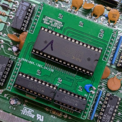

        1. Hi, I’m just a layman here but from what I’ve read the project uses “128Kx8 SRAM, DIP32 or SOP32” and two discreet 74 series chips (74HCT32, 74HCT573).
          So it seems the SRAM technology used in the project is “dumb” (microcontroller free) and
          not much different two what had existed in the 80s or early 90s (the C64 was sold new up to the 90s).
          If my memory serves we well, such high-capacity DIP32 SRAM chips did exist by early 90s, at very least.
          But anyway, it would be an interesting philosophical question if, say, an 8042 or 8051 based microcontroller
          and some modern, non-intelligent RAM chip was used in the project to manage/provide the RAM.

    2. I emulated memory for a 6502 once. I had to use a Teensy4 to do it with some dirty tricks like counting individual clocks.
      The nasty thing is that your “memory” has to get the task of reading/writing and presenting done within the tiny window of time that a 6502 has sent out an address and clocks in the data. Which happens within a single clock-cycle with timings of like <350nS at 1Mhz. Trying to capture a write is even nastier as it very quickly clears the data bus the moment the R/W switches which normally clocks the RAM in so you got to anticipate the write. Oh and let’s not forget that the Address bus is 16-bit.
      Suddenly you are looking at needing significantly more speed than your typical 8-bit MCU can provide. Silver lining is that your MCU is more likely to have more than 64Kb SRAM at this point. So you can just use the MCU’s own working memory.
      1. Some MCUs come with some logic blocks that can run autonomously, ie the pi pico has pretty advanced logic blocks and pipelines that can offload the cpu. But still SPI is probably still too slow.

  4. I don’t think the used SRAM is much younger then the DRAM it replaces. Looking at the foto the datecode seems 0003 which translates to 3rd week of 2000. I doubt they are still being produced, esp the DIP version.
    So the problems shifts.. but in the mean time the CPU and other chips will die
    1. New parallel-interface 128Kx8 SRAM in DIP packages is still manufactured by Alliance Memory and is available from Digikey and Mouser. In the Digikey catalog it looks like quite a few companies are still manufacturing parallel-interface SRAM in DIP packages in low-capacity sizes like 8Kx8 to 512Kx8.
    2. Except the available source of DRAM that first 80s era computer are the old stock. There hasn’t been any new small DRAM chips in years. SRAM OTOH are still produced that are ideal for 80s era computer.

    There have been a few different solutions to replace the C64 DRAM with SRAM available to buy or build for some years now.
    Some, like this one partially or fully demultiplex the memory address bus.
    Others don’t bother and just connect the SRAM directly to the CPU address bus. The VIC-II outputs A0-A11 on the CPU bus to be able to access the character ROM, colour RAM and the expansion port in Ultimax mode. A12-A15 can be grabbed from the memory bus.
  7. I like the solution as it uses chip series that would been around at the time. The 74LS573 brings back a lot of happy memories dabbling with 8bit CPUs.
