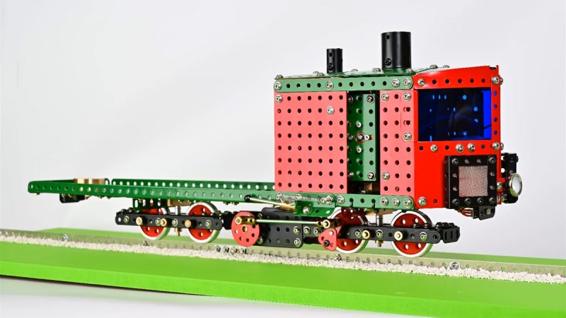

Lately, this peculiar little single wheel monorail came to our attention. Built by [extraglide1976], all from Meccano. His build started with modest tests: one gyro obviously flopped. Two gyros geared together ran slightly better. But when he adds active gimbal control, things suddenly come to life – the model shudders, catches itself, and carries on. The final green-roofed locomotive, with LEDs signalling ‘system go’, trundles smoothly along a single rail on [extraglide1976]’s deck.

The thing you’ll see in nearly all these monorails is how the carriages are designed to clamp onto the tracks. This is of course the most safe option, but it loses out on speed to the ones that sit on top of the tracks, balancing on one wheel. Such a train was actually invented, in 1910, by Louis Brennan. His original monorail promised faster, cheaper transport, even using existing rails. The carriages leaned into turns like a motorbike, without any intervention from the driver. Two counter-rotating gyroscopes kept the carriage upright, cancelling precession forces like a mechanical Jedi trick.
