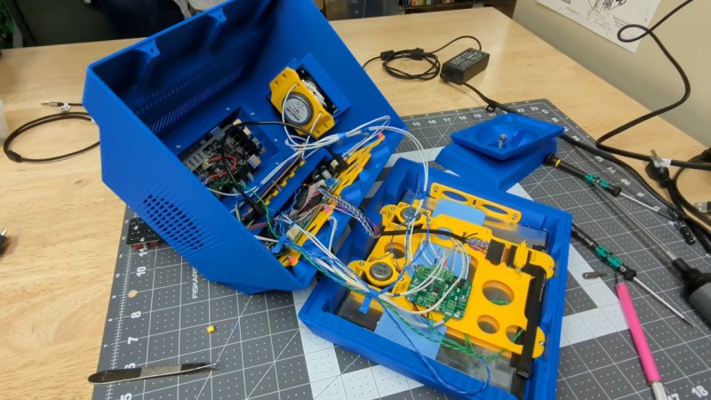

For [RetroBuiltGames] the aesthetic was obviously a big part of it– he’s inspired by the Amiga 1000’s monitor, and a tiny tilting Sony CRT TV.  He was obviously looking for many inputs, as given by the title, and he has an unusually high interest in pixel density for a retro enthusiast. Hence a 9.7″ 2K iPad display forms the basis of the project. The multi-input aspect is provided by a retrotink clone whose PCB lives in a bulge on the back of the unit that could easily house an SBC if you wanted an all-in-one emulation station– it already has a couple of decent speakers mounted in the sides.
Another big piece of the puzzle we don’t see enough of in such projects is Design For Manufacturing– the manufacturing method of choice being FDM 3D printing. The whole assembly was designed in chunks that can be easily printed  with the most visible surface flat on the bed – and if assembly proved difficult, than the parts were redesigned. His explanations aren’t a full DFM course by any means, but it’s good to see these things considered. If you need more detail on that front, we’ve featured plenty of such guides before.
