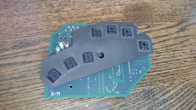

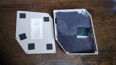

Tour and Teardown
It’s difficult to give a fair assessment about a device without using it for a while. So far, I haven’t been able to do that. But outwardly, the BAT feels like it was designed for the best possible user experience.
The BAT’s keys take very little actuating force because of the springs. Image via Deskthority
The point of a keyboard like this is that you should never have to look down at your hand(s). To help with that, both of the red and blue thumb keys have homing bumps, and the gray one doesn’t.
All the keycaps seem to be mounted backwards, as in 180° from normal — and based on the pictures I’ve found, this is how Infogrip intended them to be. This way, the keys have a really low profile and are easier to actuate. The pinky key is taller than the rest to account for how short and weak pinkies tend to be. And underneath each keycap, there are three layers of 1/8″ thick foam to absorb the shock of typing.
The BAT’s keyswitches are Cherry MX blacks that have been modified with exceptionally light springs that make them take even less force to actuate than reds. I can’t fathom how they could have made this keyboard any easier or more comfortable to type on, unless maybe the wrist rest was gel instead of foam, or it had adjustable tenting to change the typing angle.

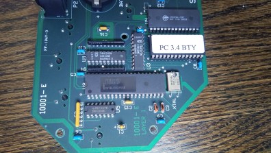

I don’t understand why it has a coin cell, especially considering this troubleshooting blog post from Infogrip that suggests removing the battery altogether because “you don’t need it and it can cause problems”. Does anyone know or care to speculate? I did try this, along with the hard reset sequence, but it still behaves the same way.

  2. Speculation on coin cell:
    Was intended to support some feature that didn’t make the final firmware.
    I have a project that initially was planned to have an RTC. Board includes all the parts (including soldered coin cell), but the firmware architecture changed mid-project and it doesn’t currently do anything with the RTC data.
    About 150 units per year are still being produced, complete with unused RTC & coin cell, because change is not simple.
    1. My guess is that the coin cell is backing up the ram that stores the user programable programmable macros.
      So you don’t have to re-program them when you turn on/off the PC.
  3. In the worst case, you can always do a brain replacement surgery on the device — put a modern microcontroller with USB support in it, and program it using the documented chords as a reference. Might actually be less work than figuring out what is wrong with it.
    1. I was thinking about a half-way-house. See if you can spot serial data anywhere on the existing board or connectors and take that into a microcontroller to convert to USB (or Bluetooth)
    1. and like the Microwriter, I wonder if it was intended to be used offline writing into that 32k battery backed ram, and then you could trigger it to squirt your novel out over the original serial port.
      32k seems like an awful lot of macro storage space
  4. Could you put up a picture of the non-component side of the board? The main question I have is if the P1 connector is a power supply connector. You wouldn’t think it would need it, but you never know.
