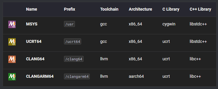

The MSYS2 Environments
When you first install MSYS2, the most important thing to learn are the distinctions between the various MSYS2 environments. This is the first thing you see after happily installing MSYS2, finding yourself staring at a list of various terminal options, as summarized below. Over the years a number of these environments have been retired, in particular the 32-bit environments, but also the MinGW64 environment that used to be the primary one until Windows 10 added the Universal C Runtime (UCRT).
The MSYS2 environments page provides a lot more detail, but the brief summary is that you should just use the UCRT terminal. It builds upon the MSYS environment just like the other options, essentially setting up a number of defaults, with some of these listed in the above table. Although you can use the Clang environments, these aren’t nearly as mature or full-featured, so your mileage may vary there.
