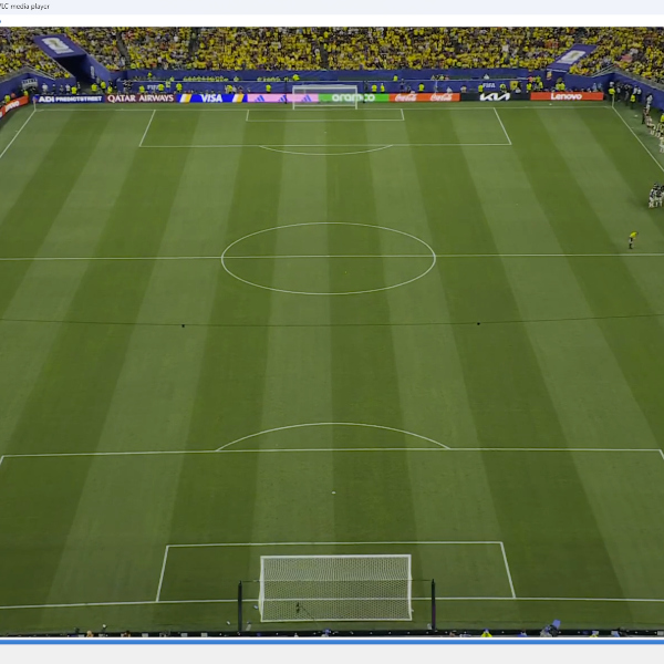

A VLC media window with a live feed of a soccer field. Players are just starting to come off the sideline to play.
Sometimes, hacking requires a certain amount of restraint, especially when you find a system woefully unsecured. It would be so easy to play some pranks, but [bobdahacker] chose not to rickroll the entire FIFA World Cup.
The fun starts after [bobdahacker] signed up for a free FIFA agent profile. After a simple ID verification process, he had a login for the FIFA Agent platform, but they used the same account system across the whole organization in Microsoft Entra. When he tried to access the FIFA Football Data Platform system, it returned an error saying he had no assigned role to allow access. This was on the client side though, so he was able to bypass the error as the server didn’t block accounts without assigned roles.
Once inside, he found he was able to access not just the data, but had full control of the RTMP ingest URLs of all the FIFA matches. For those of us less conversant in streaming media protocols, “Those RTMP ingest URLs are the literal pipe from the stadium cameras to FIFA’s broadcast distribution chain. Camera -> RTMP ingest -> MediaKind -> broadcast partners -> your TV.” He could’ve shut off the feeds or injected whatever alternate stream he wanted, but instead chose to try contacting FIFA, their streaming contractor, and various law enforcement agencies since the World Cup was already underway when he made the discovery.
“Competitions, Matches, Teams, Tools, Exchange Platform, Analysis Dashboard, Commentator Information System, FIFA AI Pro, Admin” were also in the open. Live match scores could be changed, player bios, and any number of other stats could be modified. We’ll let you imagine the possibilities of what mischief could occur.

  9. FIFA are not using public internet RTMP to get broadcast-critical stadium camera feeds back to the IBC for global TV production.
    THe majority of the cameras are UHD HDR (a few are HD HDR, a few are high frame rate for slowmos, etc). FIFA HBS is operating a private Broadcast Contribution Network between IBC and venues to carry full uncompressed or losslessly-compressed signals between venues, MCR and centralised production facilities.
    I believe all 16 venues are producing their main ESF (Extended Stadium Feed) on-site as UHD HDR, delivering back to the IBC uncompressed. Other cameras are delivered back in JPEG-XS for bandwidth reasons. Every microphone is also delivered back to Dallas and multiple stereo, surround and immersive broadcast mixes are created for each game. There’s ~600 Gbit/sec of bandwidth between each venue and MCR, delivered via two 100 Gbit/sec paths, each with multiple redundant routes.
    See https://www.sportsvideo.org/2026/06/12/how-decentralized-production-may-well-be-the-legacy-of-the-2026-fifa-world-cup/ and https://ibctours.tv/stop-2-central-equipment-room/ for more technical info.
    Bob da Hacker states on his blog, “Those RTMP ingest URLs are the literal pipe from the stadium cameras to FIFA’s broadcast distribution chain. Camera -> RTMP ingest -> MediaKind -> broadcast partners -> your TV.”
    Those match feed RTMP ingest URLs are very likely feeding an ancillary system, FIFA’s Football Data Platform, used by people registered as Agents through the FIFA Agent Platform. They will have the various available angles for each match alongside the game stats, but those feeds are NOT the broadcast-critical feeds for the main TV production. I think Bob is misinformed in this case or has made an assumption without doing more research.
    Major broadcasters will have a hand-off directly in Dallas between themselves and FIFA’s MCR (with feeds from the MP router). Alternatively, they’ll receive high-quality streams over various private/broadcast-grade methods derived from the MP router (which is quite often SRT using a private distribution network), for broadcasters who can’t afford to co-locate their own kit and connectivity in Dallas.
    Neither FIFA nor broadcast partners will be rebroadcasting low-bitrate 1080p RTMP feeds only intended for FIFA’s Football Data Platform. My belief is that the only people he might have rickrolled or disrupted would have have been people like team members or staff in delegations using the FDP portal to follow games.
