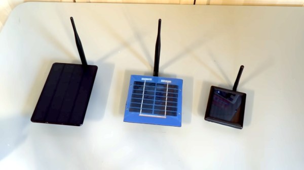

A Meshtastic node has been one of the toys of the moment over the last year, and since they are popular with radio amateurs there’s a chance you’ll already live within range of at least one. They can typically run from a lithium-ion or li-po battery, so it’s probable that like us you’ve toyed with the idea of running one from a solar panel. It’s something we have in common with [saveitforparts], whose experiments with a range of different solar panels form the subject of a recent video.
He has three different models: one based around a commercial solar charger, another using an off-the-shelf panel, and a final one using the panel from a solar garden light. As expected the garden light panel can’t keep an ESP32 with a radio going all day, but the other two manage even in the relatively northern climes of Alaska.
As a final stunt he puts one of the nodes out on a rocky piece of the southern Alaskan coastline, for any passing hacker to find. It’s fairly obviously in a remote place, but it seems passing cruise ships will be within its range. We just know someone will take up his challenge and find it.
