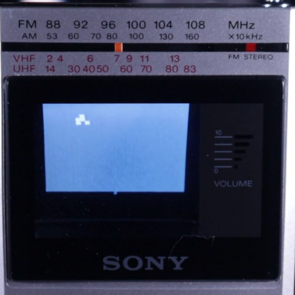

Although the CRT has largely disappeared from our everyday lives, there was a decades-long timeframe when this was effectively the only display available. It’s an analog display for an analog world, and now that almost everything electronic is digital, these amazing pieces of technology are largely relegated to retro gaming and a few other niche uses. [Maurycy] has a unique CRT that’s small enough to fit in a handheld television, but since there aren’t analog TV stations anymore, he decided to build his own with nothing but an 8-bit microcontroller and a few other small parts.
The microcontroller in question is a fairly standard 8-bit AVR. These microcontrollers have one major limitation when generating the VHF and UHF radio signals needed for analog TV: their natural clock speed is much too low. The maximum output frequency of a pin on this microcontroller is only 6 MHz, and [Maurycy] needs something about two orders of magnitude faster. To solve this problem, [Maurycy] uses a quirk of the square wave generated by toggling a pin at its maximum frequency, which is that a wide range of harmonics will be generated, some of which will have a high enough frequency to be picked up on the handheld analog TV. The microcontroller is configured to use two pins.  Toggling the pins into various states allows the humble AVR to generate a usable TV signal.
The scan rate for CRTs is comparably low as well. At the beginning of each frame, there’s enough processing power left on the microcontroller to play Conway’s Game of Life, which is then sent out over the airwaves to the TV. [Maurycy] notes that his harmonics-based video generation method is extremely noisy and probably wouldn’t pass FCC muster.  However, the signal Power is so low that it’s unlikely to interfere with anything. If you’re curious about these unusual sideways-built CRTs, though, we recently saw someone take two apart and use them to build a CRT-based VR headset.

    1. The cute/bizarre thing here is that he says he’s “just” emitting a 6MHz square wave, and relying on sharp enough edges from the pin drivers to emit loud enough noise at the 29x harmonic to be decoded as System-M channel 7. (Nominal 175.25MHz, actually sending at 174MHz).
      But why channel 7? If he’s starting with 6MHz, he should get better results on all of channel 2 (9x harmonic, 54MHz should be 55.25), channel 4 (11x harmonic, 66MHz should be 67.25), and channel 5 (13x harmonic, 78MHz should be 77.25).
      The amount of signal up at 29x should be minimal, and yet he’s showing good reception. It seems far more likely that his receiver is badly out of calibration…
      1. Agreed on all that. I can only assume that “few cm of wire” he uses as an antenna is much more efficient at the higher frequencies. Likewise the receiver’s antenna.
      2. avrs can usually go up to 20 mhz if not more. you can get 12 and 18 mhz crystals which might better hit the harmonic. idk im not really a radio nerd. i presume he picked 6mhz for a reason.
      3. Author here, the circuit is in fact transmitting on >200 MHz, as confirmed by two spectrum analyzers and multiple radio receivers.
        The best range was actually at lower frequencies. At ten meters, with some fiddling around to find the strongest signal and best antenna position, the image is very noisy but it is still clearly there. I was testing in a remote area, so the band was fairly quiet and even a microscopic amount of power can carry quite far.
        Sure, it sounds crazy, but with 4 different radios and 2 different spectrum analyzers agreeing (and a using a signal generator to check that the TV’s tuning indicator is correct), I think the sensible conclusion is that digital devices are really that noisy. There’s a reason the FCC regulates anything with a computer in it: Interference from digital devices is far from a theoretical concern.
