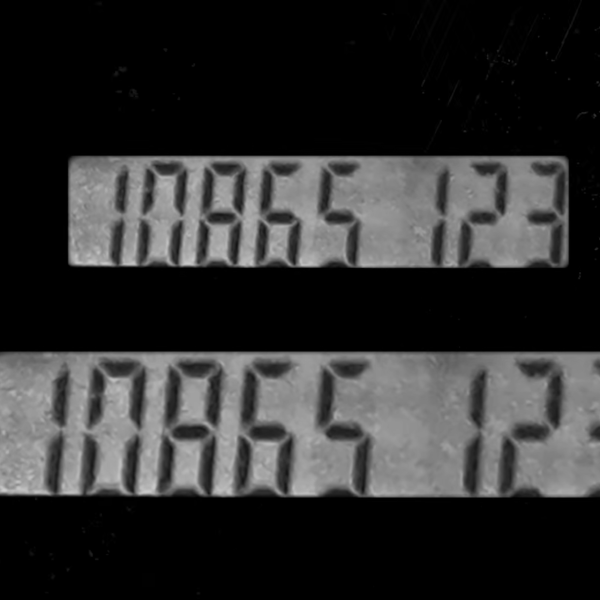

In an ideal world, the role of technology would be to make all of our lives easier. And although all the ads suddenly appearing in our smart TVs and gaming systems might make it seem otherwise, some technology can still improve our lives if we work hard at it. For [Cian], that meant training a neural network to read his gas meter so he wouldn’t have to do it himself.
The root issue here is twofold, first that [Cian]’s gas company hasn’t upgraded their own technology to modern, remote-readable meters, and second that the meter can’t be read by a gas employee because it’s hidden in the depths of [Cian]’s basement. This latter fact requires him to delve into Moria-like depths to get to the meter, so the solution here was to place a Raspberry Pi in this location instead. With a camera pointed at the meter, it’s not quite capable of discerning digits on its own so a neural network was trained in order to get accurate readings of the dial. And, finally, since the machine is networked already [Cian] set it up to automatically notify the gas company of its reading so he is now completely out of the loop.

  1. Wouldn’t it be eeasier and more accurate to sample the pixel color in certain places and calculate the correct digit? It’s a segmented display after all so it can only be (shades of) “black” or “white”
    1. The meter already has an interface for this. But even without, you could just measure a single segment in the last digit using a photodiode and an LED.
  2. AI is overkill for this, unless you’re doing it as a learning experience. OpenCV can do this just as well. Since the segment positions and sizes don’t change you can just strip it to black and white, and average colors for regions.
    1. He’s using OpenCV, walks you through the whole process of training from a dataset captured for his specific task and provides images for you to duplicate his setup if you want. The least you could do is read his write up.
      1. I mean that there is no training or AI required. All you have to do is define regions within the image that match the segment positions, get The average color and that tells you whether the segment is on or off
        1. So implement that, and let us know how well it works in real world conditions.
          I don’t know about you, but I’ve done things like this, and wish I had better tools at the time. Simplistic rulesets tend to not work in the real world under real world conditions where you don’t have full control of everything.
          1. I have in the past for a radio receiver, reading a backlit LCD for the current frequency. It worked fine for the same reason it would here; that you do have control of everything. The display is fixed in position and distance, you can set up the lighting however you wish, and you can put an enclosure around it to keep out stray light.

    1. Yeah I ran that, it didn’t cope well with my analogue meter despite matching the training set well and very slow moving numbers. Took a good while to set up the digit areas etc but they still kept getting false readings when they were not “whole”. I gave up in the end and just used the camera to take my readings manually in the end. I think the comment above about just sampling pixels in specific locations and decoding them that way makes far more sense for a digital display, the neural net is overkill, but it’s a fun project to try.
      1. the neural net is overkill, but it’s a fun project to try
        I mentioned it in some other comments on the Youtube video, but that’s what I was aiming for. To learn more about neural networks and how they work. There’s more than a dozen ways to skin this cat at the end of the day – but it was a learning experience which I wanted to get out of it
        1. I enjoyed reading your writeup. Thank you, this is a project I have been considering for a long time. I am interested in doing something similar for a water pressure meter with an analog rotary dial indicator. Any thoughts?
    2. I never got it working with my analog water pressure gauge. I guess i would have to train it with the gauge, but just no.

  6. Adjust the focal range close enough that the display fills most of the image drop the resolution right down, maybe give it an led to keep illumination fairly consistent. As long as the camera stays fairly still, you only really need to read one pixel in the middle of each segment and give it a threshold value to assess light or dark. No doubt far more trustworthy than the statistical nature of a neural network.
