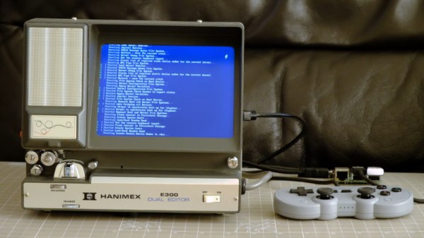

With the convenience of digital cameras and editing software, shooting video today is so easy. But fifty years ago it wasn’t electronics that stored the picture but film, and for many that meant Super 8. Editing Super 8 involved a razor blade and glue, and an editing station, like a small projector and screen, was an essential accessory. Today these are a relatively useless curio, so [Endpoint101] picked one up for not a lot and converted it into an HDMI monitor.
Inside these devices there’s a film transport mechanism and a projection path usually folded with a couple of mirrors. In this case the glass screen and much of the internals have been removed, and an appropriate LCD screen fitted. It’s USB powered, and incorporates a plug-in USB power supply mounted in a UK trailing socket for which there’s plenty of space.
There’s always some discussion whenever a vintage device like this is torn apart as to whether that’s appropriate. These film editors really are ten a penny though, so even those of us who are 8 mm enthusiasts can see beyond this one. The result is a pleasingly retro monitor, which if we’re honest we could find space for ourselves. The full video is below the break. Meanwhile it’s not the first conversion we’ve seen, here’s another Hanimex packing a Raspberry Pi.

Browsing though the junk store one day [Alec] spotted an old school 8mm film editor. For those who weren’t around, video used to be shot on film and editing it was a mechanical task of cutting (with a sharp implement) and pasting (with special tape) back together. It’s sad to see these in junk stores, but great for [Alec] who thought it begged to have an LCD and a single board computer implanted in it.  Once the editor was in hand, the machine was gutted of its very simple parts: a lamp, some mirrors and a couple of lenses. He took measurements of the hollowed out enclosure and got down to business.
The hunt for a 4:3 aspect ratio LCD was on. Through a little bit of research, an LCD security screen was ordered from Alibaba. For the brains of the build an OLinuXino A13 board was chosen due to its native VGA output perfect for the LCD screen, a decent 1GHz Allwinner CPU, and the physical size which would fit in the editor housing.
With some haggling, Linux was installed on the SBC along with some games and the system was buttoned back up. A neat touch was added to the arms where you would originally place your film reals in the form of some fold out speakers, making the whole thing look like something direct out of a classic Sci-fi film. Check out the name of the project: PCsr, pronounced PC Senior… nice!
