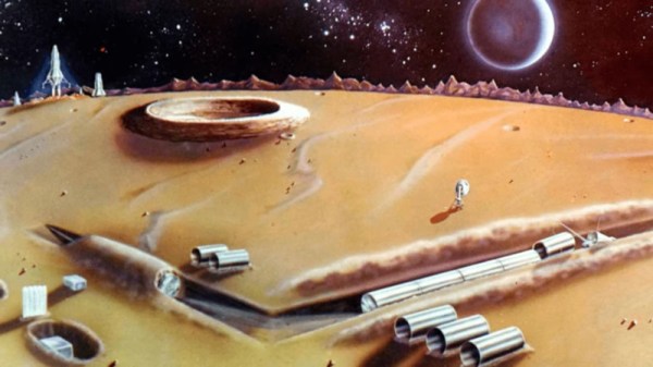

If you were alive when 2001: A Space Odyssey was in theaters, you might have thought it didn’t really go far enough. After all, in 1958, the US launched its first satellite. The first US astronaut went up in 1961. Eight years later, Armstrong put a boot on the moon’s surface. That was a lot of progress for 11 years. The movie came out in 1968, so what would happen in 33 years? Turns out, not as much as you would have guessed back then. [The History Guy] takes us through a trip of what could have been if progress had marched on after those first few moon landings. You can watch the video below.
The story picks up way before NASA. Each of the US military branches felt like it should take the lead on space technology. Sputnik changed everything and spawned both ARPA and NASA. The Air Force, though, had an entire space program in development, and many of the astronauts for that program became NASA astronauts.

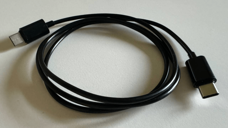

A coiled black USB-C to USB-C cable is shown on a white background.

Most people know that they shouldn’t plug strange flash drives into their computers, but what about a USB cable? A cable doesn’t immediately register as an active electronic device to most people, but it’s entirely possible to hide a small, malicious microcontroller inside the shell of one of the plugs. [Joel Serna Moreno] and some collaborators have done just that with their Evil Crow Cable-Wind.
This cable comes in two variants: one USB-A to USB-C, and one with USB-C to USB-C. A tiny circuit board containing an ESP32-S3 hides inside a USB-C plug on each cable, and can carry out a keystroke injection attack. The cable’s firmware is open-source, and has an impressive set of features: a payload syntax checker, payload autocompletion, OS detection, and the ability to impersonate the USB device of your choice.
The cable provides a control interface over WiFi, and it’s possible to edit and deploy live payloads without physical access to the cable (this is where the syntax checker should be particularly useful). The firmware also provides a remote shell for computers without a network connection; the cable opens a shell on the target computer which routes commands and responses through the cable’s WiFi connection (demonstrated in the video below).
The main advantage of the Evil Crow Cable Wind is its price: only about $25, at which point you can afford to lose a few during deployment. We’ve previously seen a malicious cable once before. Of course, these attacks aren’t limited to cables and USB drives; we’ve seen them in USB-C docks, in a gaming mouse, and the fear of them in fans.

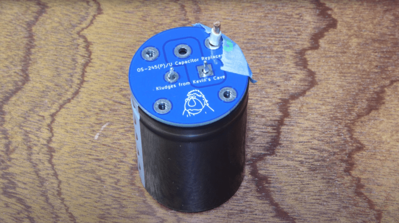

Capacitor Adapter board
Kludge Compensates For Kaput Component With Contemporary Capacitor
It is a well-known reality of rescuing certain older electronic devices that, at some point, you’re likely going to have to replace a busted capacitor. This is the stage [Kevin] is at in the 3rd installment in his saga of reviving a 50-year-old Military Tektronix oscilloscope.
[Kevin] recently discovered a failed capacitor in the power supply for this vintage analog scope. Having identified and removed the culprit, it was time to find a way to replace the faulty component with a modern equivalent. The original capacitor is out of fashion to the degree that a perfect replacement would be impractical and likely not desirable. This job would call for a bit of adaptation.
