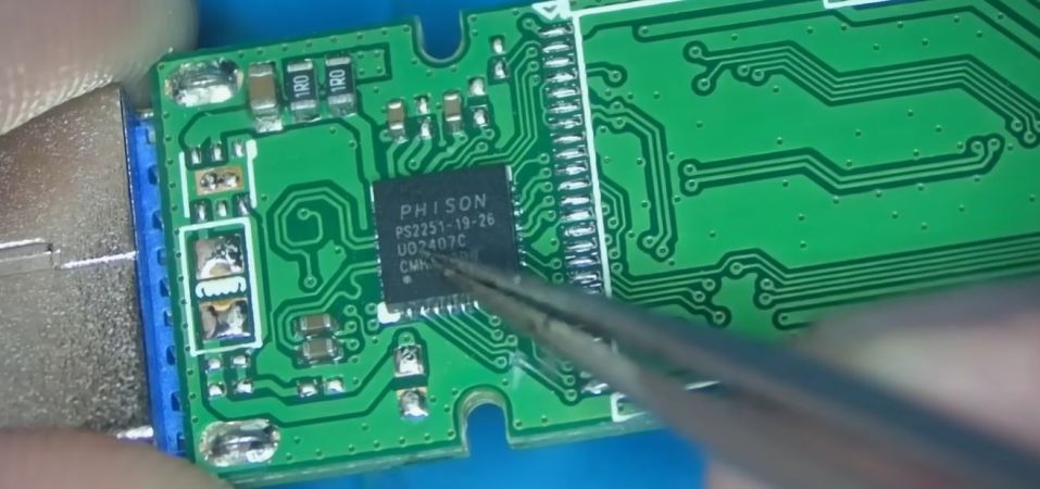

Although these all have USB 3.0 interfaces, they transfer at less than 30 MB/s, but why exactly? After popping open a few of these drives the answer appears to be that they use the old-style Phison controller (PS2251-09-V) and NAND flash packages that you’d expect to find in a USB 2.0 drive.
Across the 32, 64, and 256 GB variants the same Phison controller is used, but the PCB has provisions for both twin TSOP packages or one BGA package. The latter package turned out to be identical to those found in the iPhone 8. Also interesting was that the two 256 GB drives [Chase] bought had different Phison chips, as in one being BGA and the other QFP. Meanwhile some flash drives use eMMC chips, which are significantly faster, as demonstrated in the video.
