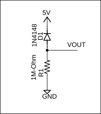

[Dhananjay Gadre] happened across a useful little trick the other day. Take any old 1N4148 or 1N914 glass-package signal diode and wire it up right, and you’ve got yourself a nifty little IR detector.
It’s that simple.

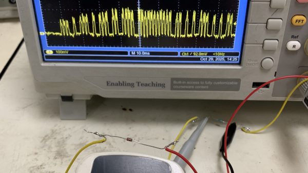

The trick is to treat the diode just like you would a proper IR photodiode. The part should be reverse biased with a resistor inline, and the signal taken from the anode side. Point an IR remote at your little diode and you’ll readily see the modulated signal pop up on a scope, clear as day.
The phenomenon is discussed at length over on Stack Exchange. Indeed, it’s a simple fact that most semiconductor devices are subject to some sort of photoelectric effect or another. It’s just that we stick the majority of them in opaque black packages so it never comes up in practice. In reality, things like photodiodes and phototransistors aren’t especially different from the regular parts—they’re just put in transparent packages and engineered and calibrated to give predictable responses when used in such a way.
Is this the way you’d go if your project needed an IR detector? Probably not—you’d be better served buying the specific parts you need from the outset. But, if you find yourself in a pinch, and you really need to detect some IR signals and all you’ve got on hand is glass-package signal diodes? Yeah, you can probably get it to work.

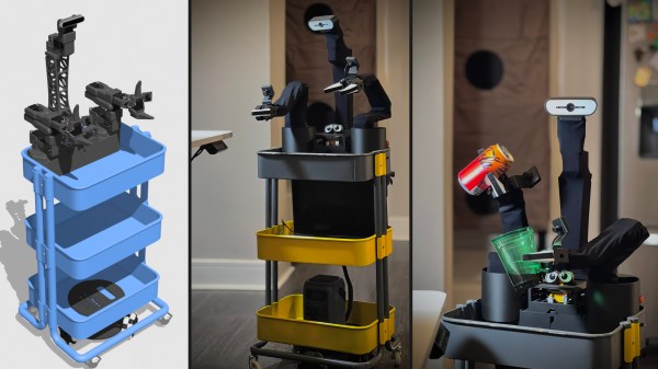

There are many incredible open-source robotic arm projects out there, but there’s a dearth of affordable, stable, and mobile robotic platforms with arms. That’s where XLeRobot comes in. It builds on the fantastic LeRobot framework to make a unit that can be trained for autonomous tasks via machine learning, as well as operated remotely.
XLeRobot, designed by [Vector Wang], has a pretty clever design that makes optimal use of easy to obtain parts. In addition to the mostly 3D-printed hardware, it uses an IKEA cart with stacked bin-like shelves as its main frame.
The top bin holds dual arms and a central stalk with a “head”. There’s still room left in that top bin, a handy feature that gives the robot a place to stow or carry objects.
The bottom of the cart gets the three-wheeled motion unit. Three omnidirectional wheels provide a stable base while also allowing the robot to propel itself in any direction and turn on a dime. The motion unit bolts to the bottom, but because the IKEA cart’s shelf bottoms are a metal mesh, no drilling is required.

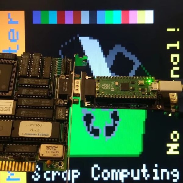

VGA isn’t much used anymore, but it’s not hard to get a hold of monitors with that input. How about the older standards like EGA, CGA, or MDA? Well, it’s good luck on eBay or at the recycling yard to get a period-appropriate monitor, but the bulky, fragile CRTs seem to have been less likely to survive than computers that drove them. That’s what [Scrap Computer]’s MCE Blaster is for: it sits betwixt the retrocomputer’s TTL output and the VGA input of a (more) modern monitor, be it CRT or LCD.

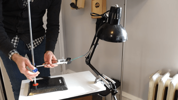

If you’re a musician and you want a reverb effect, there are lots of ways to go about it. You can use software plugins, all kinds of rack-mount effects, or pedals. Or, as [David] has done, you could go with a lamp.
[David’s] build is straightforward enough in concept—he just chose a relatively unconventional item to use as a reverb tank. The lamp might seem like an odd choice, but it actually does a decent job at resonating because of its metal construction and the multiple springs that tension the structure. [David] turns the lamp into a reverb by fitting it with a Vidsonix Ghost audio transducer to put sound into the structure—picture the magnetic driver of a loudspeaker without the cone fitted, and you get the idea. Piezo elements were then used as contact mics to pick up reverberations from the lamp itself. Everything was assembled with a bunch of lab stands that give the build a rather nice aesthetic. The reverb time isn’t particularly long, but the sound is hauntingly beautiful.

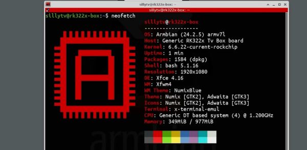

Marketplaces and e-waste recycling centers are practically overflowing with the things: ARM-based streaming TV boxes that run some — usually very outdated and compromised — version of Android. While you can use them for their promised streaming purposes, they’re invariably poorly optimized and often lie about their true hardware specifications. Which leaves the most important question: can you install Linux on these SBCs and use them as a poor man’s Raspberry Pi alternative? The answer, according to [Oleksii’s Tech] on YouTube is ‘sorta’.
The commonly seen X96Q clone Android TV box that [Oleksii] bought for $10 is a good example. The clone advertises itself as based on a quad-core Cortex-A53 AllWinner H313 SoC, like the genuine X96Q, but actually has a Rockchip RK3229 inside with correspondingly far lower performance. After you have determined what the actual hardware inside the box is, you can get a copy of Armbian for that particular SoC. Here, the Rk322x-box minimal image was used, with the box booting straight off an SD card. Some Android TV boxes require much more complicated methods to even boot off external media, so this was a lucky break.
