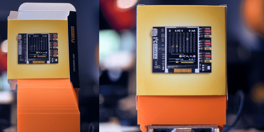

To fulfill orders on his previously covered TermDriver2, [James Bowman] is faced with folding thousands of small boxes. To aid in this daunting task, he had the idea of making a tool to streamline the process — every second saved adds up when you’re repeating a task thousands of times. He designed a 3D printed mandrel that pops the flat box blank open as it’s slid over the tapered top, shaping it into a perfect rectangle for easy folding of the top flaps.
The nice thing about 3D printng is how easy it is to iterate on a design. Once James had the first version printed and verified it worked as hoped, he had ideas to improve it, such as adding a second mandrel to twist the box from both the inside and outside and adding a guide on one side to enhance rigidity.
While we often think of 3D printers producing ready-to-use parts, but printed tooling holds great potential for repetitive tasks, and is a huge cost saver compared to traditional methods.

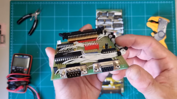

[Too Many Wires] has a custom computer he’s building. He wanted a mouse, but USB is a bit of a stretch for the fledgling computer. We might have opted for PS/2, but he went for something even older: a serial mouse connected with a DE-9 (colloquially, a DB-9). Check it out in his recent video update on the project below.
Don’t remember serial mice? They were very common many years ago, and apparently, you can still buy new ones, which makes you wonder what people are doing with them. If you are an old hand at serial, you’ll immediately know why he couldn’t get it to work at first. If you haven’t worked with RS-232 gear before, you’ll learn a lot.
The protocol is simple enough, and you can read the code or find plenty of old documents. He’s using a UART chip, which offloads the CPU. However, the PS/2 mice are very easy to work with directly, and you could skip the +/- 12V RS-232 and other issues.
Either way, however, using an RS-232 or PS/2 mouse in a project is relatively straightforward. You might not think you need a mouse, but don’t forget, they are really accurate two-axis sensors. An optical mouse on a motion table, for example, could be worth something.

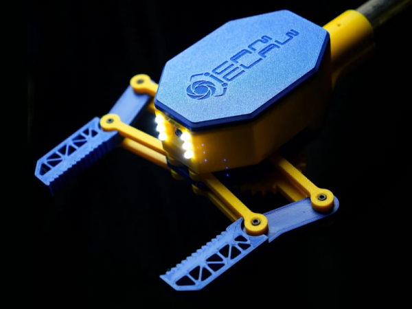

Have you ever wished your hand had an extra feature? Like, maybe, a second thumb? A scope probe pinky maybe? Well, if you are building a robot effector, you get to pick what extra features it has. [Gokux] has the aptly named Cam Claw, which is a 3D printed claw with a built-in camera so you can see exactly what it is doing.
The brains are an ESP32-S3 and the eyes — well, the eye technically — uses an OV3660 camera. There’s even a light in case you are in a dark space. A servo drives it, and the printed gear train is pretty fun to watch, as you can see in the video below.
This project is all about the mechanics. The electronic hardware is trivial. A battery, a power controller, and a servo complement the ESP32 and camera. Six LEDs for light, and the job is done.
Obviously, the gripping power will only be as good as the servo. However, we really liked the idea of putting eyes on a robot hand where they count. Of course, the claw you really want a camera on is in the arcade. We’d like to see cameras on some other robot appendages.
