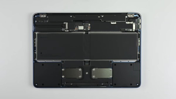

An upside down laptop with its cover removed on a grey surface. The inside of the laptop is a series of black modules connected to the frame with glorious amounts of screws and not glue!
Apple’s Most Repairable Laptop Is Thanks To Right-to-Repair
The common narrative around device design is that you can have repairability or a low price, but that they are inversely proportional to each other. Apple’s new budget MacBook Neo seems to attempt a bit of both.
Brittle snap-fit enclosures or glue can make a device pop together quickly during manufacture, but are a headache when it comes time to repair or hack it. Our friends at iFixit tore down the Neo and found it to be the most repairable MacBook since the 2012 unibody model. A screwed in battery, and modules for many of the individual components including the USB ports and headphone jack make it fairly simple to replace individual components. Most of those components are even accessible as soon as you pop the bottom cover instead of requiring major surgery.
As someone who has done a keyboard replacement on a 2010 MacBook, the 41 screws holding the keyboard in brought back (bad) memories. While this is a great improvement over Apple’s notoriously painful repair processes, we’re still only looking at an overall 6/10 score from iFixit versus a 10/10 from Framework or Lenovo.

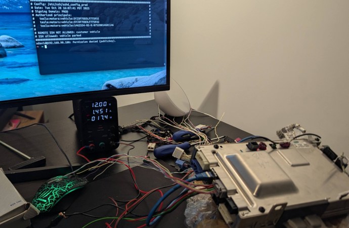

Like many high-tech companies Tesla runs a bug bounty program. But in the case of a car manufacturer, this means that you either already have one of their cars, are interested in buying one, or can gain access to its software-bits in another legal manner. Being a Tesla-less individual, yet with an interest in hunting bugs [David Schütz] thus decided to pursue the option of obtaining the required parts from crashed Tesla cars.
Specifically [David] was interested in the Tesla Model 3 and its combined Media Control Unit (MCU) and Autopilot computer (AAP) assembly. In addition to the main unit, it also requires – obviously – a power supply, and the proprietary display. These were all obtained fairly easily, but unfortunately the devices all had their cables cut off, leaving just a sad little stump of wiring with the still plugged-in connectors.
After trying his luck with an incompatible BMW LVDS cable from one of their headunit infotainment systems, he then proceeded to try and use the cable stumps with some creative patching. This briefly worked, but some debris fell onto the MCU board and blew a power rail IC.
Ultimately this IC got swapped after [David] had already purchased a whole new Model 3 computer, leaving him with two units and the easy way out of buying the Dashboard Wiring Harness cable loom that contained the Rosenberger connectors he needed to connect the display to the main unit.
