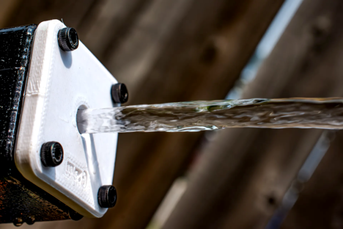

Garden Hose Gets Laminar Flow
We aren’t sure if [Joshua Bellamy] is serious that he wants a laminar flow to water his plants, but there are many places where having a smooth and predictable flow of water is useful or even essential. With his 3D printed adapter, you can produce laminar flow from any garden hose.
If you haven’t heard the term before, laminar flow is to water what a laser is to light. The water moves in parallel tracks with minimal mixing and turbulence. Ensuring laminar flow is often critical to precise flow metering, for example.
This isn’t [Joshua]’s first attempt. He has made a nozzle like this before, but it required a lot of assembly (“more fiddly bits than a Swedish flat-pack sofa” according to the post). Depending on the version, you’ll need various bits of extra hardware in addition to the 3D printed parts. Some versions have drop-in nuts and even an LED. Fiberglass insulation at the inlet diffuses turbulence, and some manual work on the output provided better results. When everything is working, the output of the hose should look like a glass rod, as you can see in the video below.
Air can also have laminar or non-laminar flow. Laminar air flow in a laser cutter’s air assist can make a big difference. If you don’t fancy 3D printing, you could save some drinking straws from your last few hundred trips to the local fast food emporium.

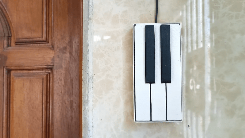

Piano Doorbell Adds Music To Your Home
Regular ding-dong doorbells are fun and all, but it can be nice to put something a little more special by your front door. To that end, [Arpan Mondal] built this neat little piano doorbell to make visiting his home just a touch more fun.
The heart of the build is an ESP32 microcontroller. It’s responsible for reading the state of five 3D printed piano keys: three white, two black. It’s nowhere near a full octave, but for a doorbell, it’s enough. When a key is pressed, the ESP32 plays a short audio sample embedded within the program code itself. This is done with the help of a PAM8403 audio amplifier module, which jacks up the output to drive the doorbell speaker loud enough to be heard throughout the home. It’s not exactly studio quality audio, but for a doorbell, it sounds pretty solid.
If you’re looking for a fun and easy build to make your home just a little bit more whimsical, it’s hard to beat something like this. Your musical friends will love it—they might even develop an intro riff of their very own. We’ve featured some other fun doorbell builds before, too—the best of which are the Halloween projects.
